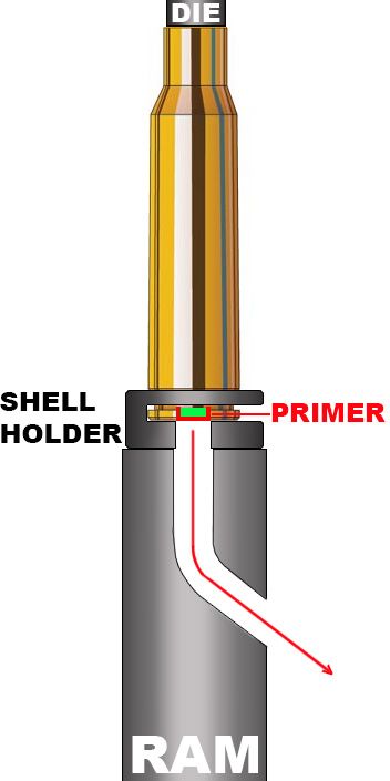

The way I read your last post, I gather that you resized loaded ammo. With the volatile properties of primers, I would caution against that. There are horror stories of ammo discharging while being resized. Please exercise all due caution.

No not resizeing factory ammo just measuring it before and after fireing.. Just trying to get it all in in one post.. I was trying to answer the question on if the die would adjust enough... I would never try and resize a loaded cartridge... That just sounds scary..lol
Resizing a loaded case (just the primer) isn't that bad if you are careful. There is nothing in the case except the primer. Normally, it take an impact to set one off. In my Lee press. If one did go off with the die inside, the pressure would be vented out the bottom and not try to burst the case. Still, I always were safety glasses when working with primers and any time popping out live primers (slow and easy) or resizing a case with one installed (nothing touches the primer if you remove the decapping pin from your die), and I wear hearing protection. Probably the worst that could happen if one went off is I'd have to change my shorts. The hole in the press ram is where the removed primers drop out of so would vent all the pressure and primer casing and on my press, it's pointed away from me. Still, never do anything that you think is unsafe.
