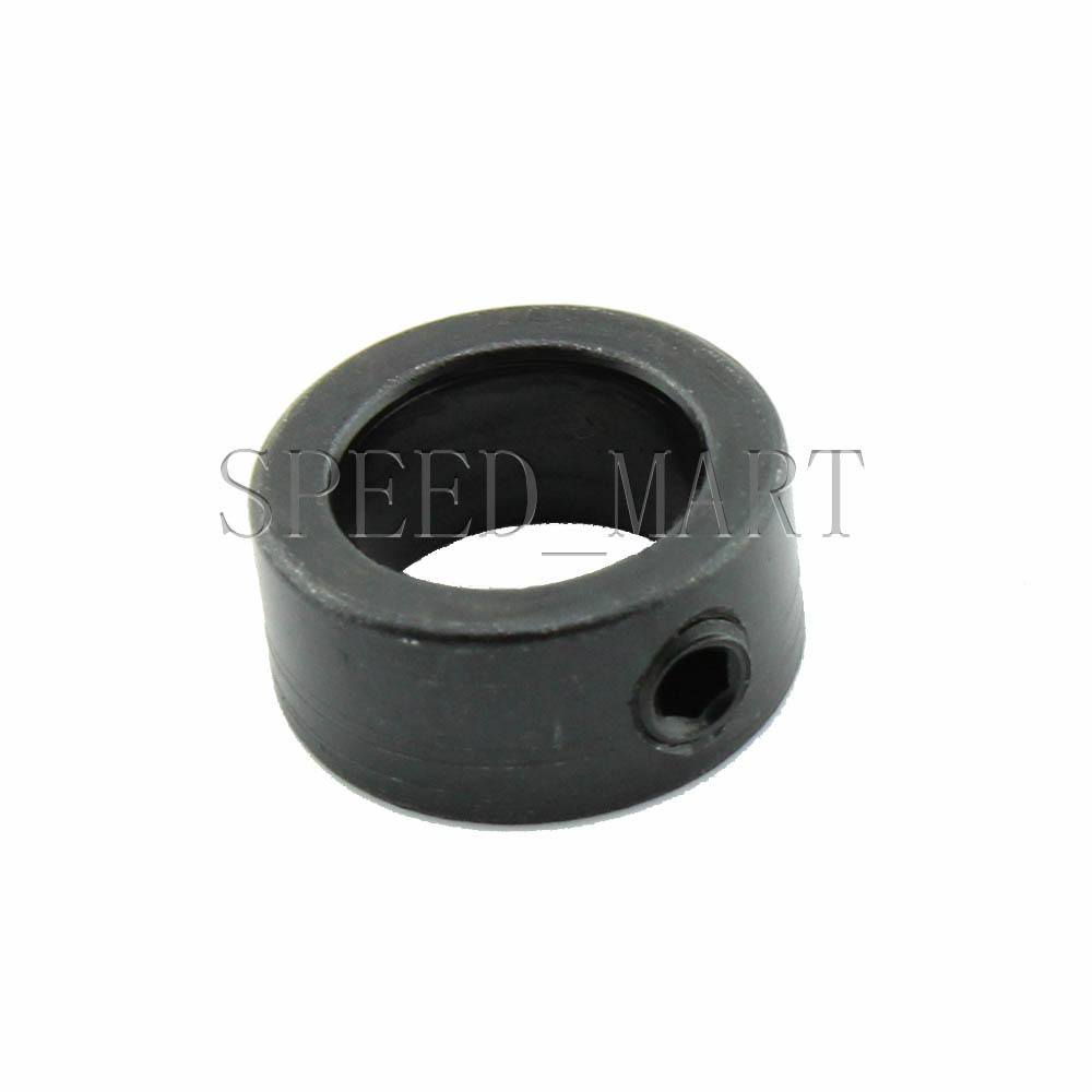

Just an idea... but you could use a length of (maybe copper) tube and slide it over a Manson or JGS throating reamer to control your depth. Just cut the tube to suit your free bore length.
Or just make a lock ring with a set screw hole. Crappy example but, something like this.
I think they are called drill bit depth stops.
