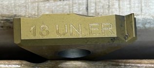

That is a carmex toolholder. The parts youre looking for is called an anvil. The one thats in there is fine for any thread we do, but carmex has an anvil selector guide if you want to get fancy.
Might also be an Iscar, they are the same and Iscar uses the same numbering system as Carmex.
Vardex, Iscar and Carmex anvils are interchangeable. Vardex anvils use a different number system but you can use their chart. I use Vardex anvils in my Iscar toolholders.

This is the setup I am using:
I believe this is a Carmex 16 ER 18 UN BXC -- Aaron, do you mean BXC or is there an BCX? I don't see that.
Is this the wrong lay-down threader for gunsmithing in stainless steel? I want to say, that I don't believe this is causing a problem, but as several people have asked me to chamber barrels for them, I'd like to produce threads that not only work but look good/great too.
