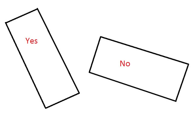

Remember some compounds are marked backwards so you may have to set it at 59.5 degrees... vs. 29.5 degrees.

The angle of the compound does get confusing for some. Even though the picture isn't accurately drawn, you should get the point. You want to be 29.5-30° off from having the compound being parallel with the cross slide.
