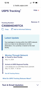

For those of you that have the Remple bipod how long did it take for you to receive it from Canada? I’m wondering if there’s an “issue” with the delivery of the one I ordered because it seems that when it arrived in Los Angeles, California (customs) the tracking stopped and there’s been no “movement” since May 10th (6 days ago).
mine was in customs a couple of days, a friend that ordered over a week before me has his there for a couple of weeks. i got mine before him.
