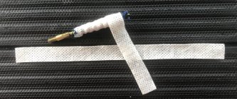

I discovered what IMO is the best way to apply a paste cleaner, whether its JB, Iosso or TC. I got some very strong long patches from Real Avid Products (link below), and wrap them around a nylon brush. You can control the bore tightness by the number of wraps in an area of the brush. They are cheap and unwind easily after cleaning. Attached is a photo. I tried their Speed Jag, didn’t work, wrapping a nylon brush was a home run.
