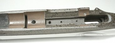

I checked the bedding on the rifle, and it looks good

This action only has two screws, one on the bottom in the front, the other comes in from the top, under the bolt, and can't be tightened down too much, not sure of actual suggested torque, but bottom screw the gunsmith that built it told me 35 inch pounds on the bottom screw.
