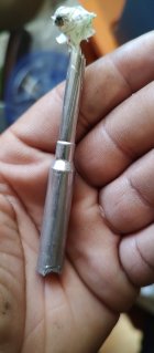

So one of my little project guns is kinda weird when it comes to fireforming and some other stuff . It's been a fun little headache lol. Was reccomended to do a chamber cast to see exactly what the chamber looks like, a while back. Well I got some chamber casting alloy and did my very first chamber cast today, deal is I'm not 100% sure what I should be looking at :D Figure I should pull up the measurements for a average .223 camber and compare that to what this measures but anything else a guy could do with a chamber cast ?
SAAMI chamber and ammo specs are free on the web and it isn't very difficult to learn to inspect ammo or chamber casts but you will need a few tools and instruments, which you will want to have in the long run anyway.
