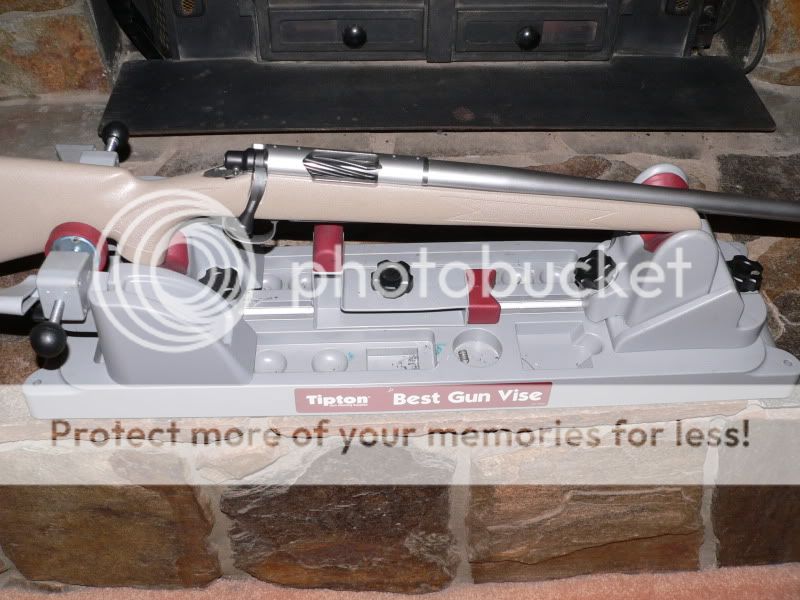

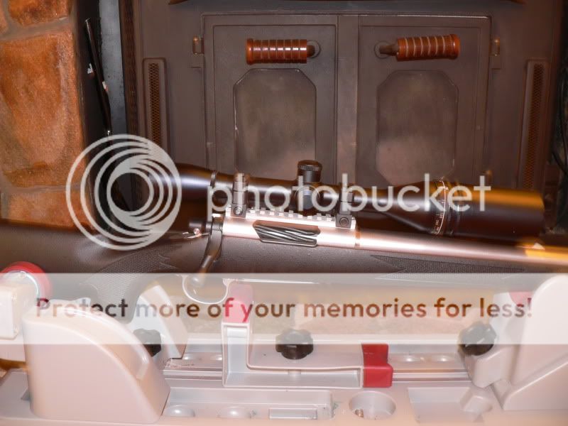

I have two customers who placed orders for a custom hunting rifles that were able to take deer at long distances. These rifes are the same except for action serial number, color, and barrel length. One has a 25" barrel and the other a 26" barrel. The actions are stiller Predator, the barrels are Broughton .284, 1:9, 5C. The stocks are McMillian, the bottom metal is PT&G Stainless Steel, the mag boxes are Wyatt Outdoors, heat treated CM, center feed. Attached are photos and the target of the first five shots from the Black rifle.
