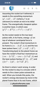

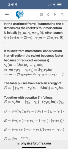

The favorite, pet question. By coincidence, I managed to shoehorn this exact question into a physics forum thread I started on time dilation regarding a satellite orbiting at relativistic speed transmitting energy via laser for 10 minutes as measured at the satellite but 30 minutes as measured on earth. The supposed 10 minute battery potential being expanded in duration was a novel thought apparently and that thread was the most active, for 2 days, some of the equations developed, and the redshift and transverse Doppler analysis being insanely eruditic.
The “one line”, unremarkable-to-anyone-else answer to this question that I fit in was this, circled below, while the participants otherwise talked in these kinds of terms.
I had already accounted for air being pushed forward, but this guy jumped right to the heart of the issue. A couple guys spent the better part of 24 hours calculating and balancing recoil from light, so…
