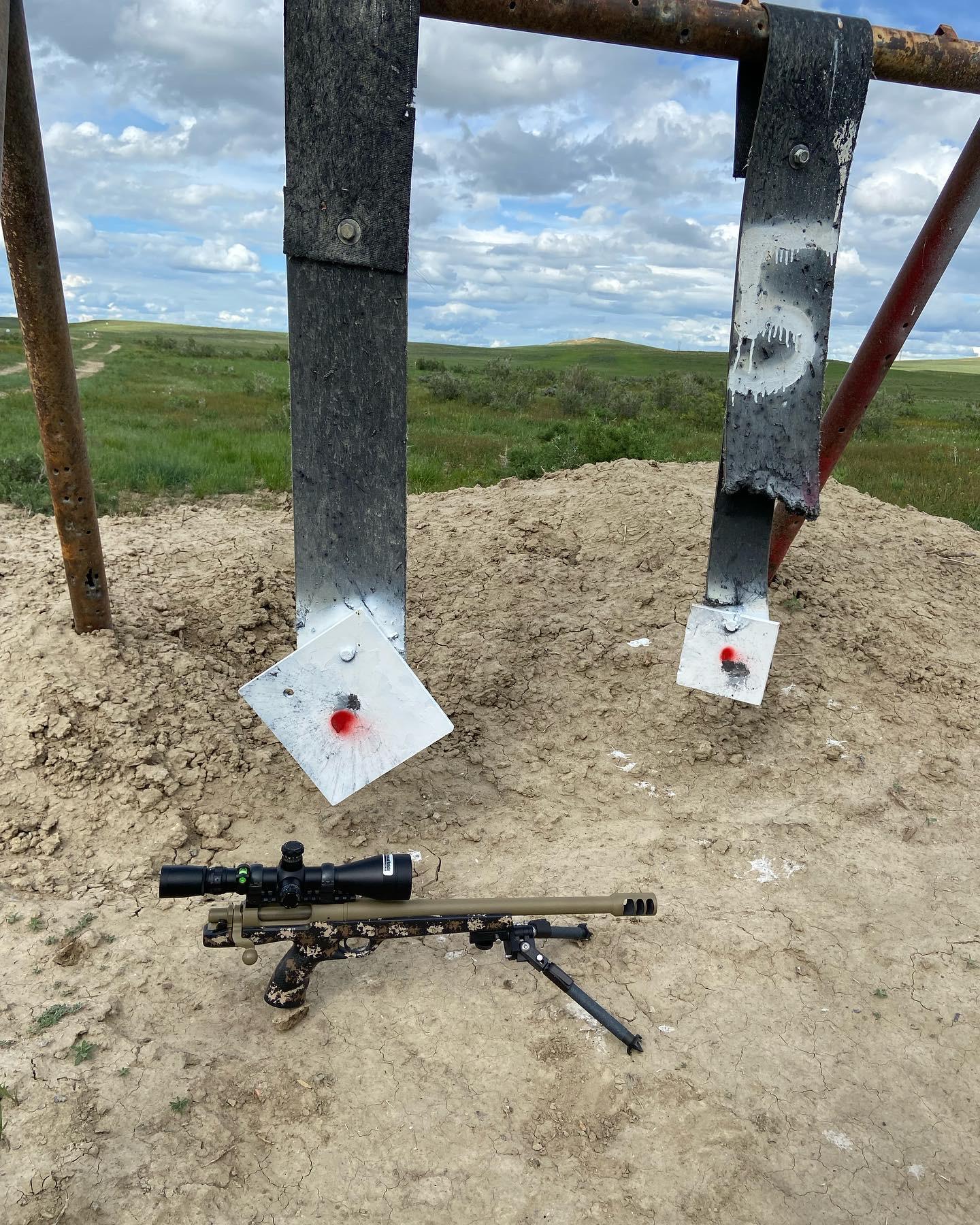

This is BCG 308 Winchester XP-100, using a Remington Take-Off 308 Winchester barrel chopped to 15.8" Holland's Radial Baffle Brake, Leupold Mark IV 4.5-15, McMillan stock, and a factory trigger.
[Linked Image from i.imgur.com]
Video Below: Factory TAP with 168 A-Max.
Reloads: 1x fired Hornady Match 308 Win brass, CCI primer, H-4895, 155 A-Max at 2720 fps.

Sunday afternoon I went out with a couple of guys from church. One needed to do load development and chronographing and the other one wanted me to chronograph a couple of guns with my Labradar.
I wanted to do some drop confirmations with the Dirty Thirty/308 Winchester. We had winds from the northwest, which was a quartering headwind for us. I was shooting to the north. After the guys got all of their stuff done, Glenn spotted for me while I started doing some drop confirmations. The quartering headwind noticeably pushed my bullets down as I extended distances, but I still had fun.
Even at 300 yards it took me more elevation to hit my target, then it should've. By 400 yards I had a sense of how much I should add at 500 yards. At 500 yards my first shot at the 10 inch diamond target was close to a center hit.

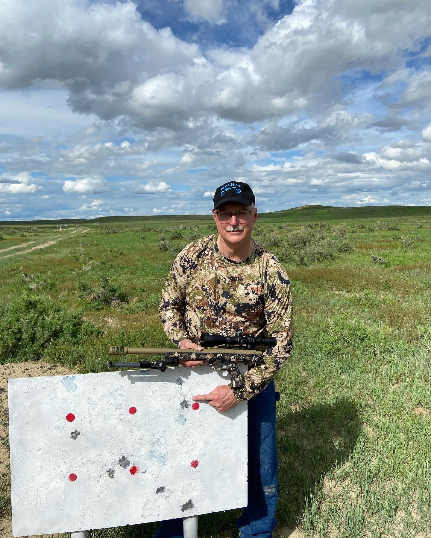

I did drop confirmations out to 800 yards, but with wind continuing to pick up, I stopped there. We shot Glenn's 41 Magnum Smith & Wesson revolver, and had some fun. I decided I wanted to shoot one more shot with my 308 Winchester XP. I picked the upper right small dot on the big rectangular target at 500 yards.
99B7AD1D 1321 4999 BD9A 30E4D923E5BA
It always feels good, when you just have a sense of what it should be and you are right, and the shot is very close to where you were aiming at a mid-range distance.
