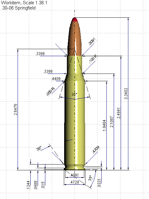

Nice post Rick. Could you put up an image of your ammo -- maybe a couple .30-06 cartridges standing and one flat, in front of an ammo box or on a target paper. I think this might make for a nice short bulletin story on the "Old warhorse".
To many of the younger generation....the Ole Warhorse is 'outdated' but I can guarantee that the 30/06 is a VERY ACCURATE cartridge for 1000 yard shooting...and even out further if need be! With some of the advanced powders that we have today....it would surprise many shooters with what it's capable of doing with the right rate of twist and sitting within a good platform! My rifle has a 1-10 ROT and I had it short-throated such that with some throat erosion I could just seat the bullets out and keep right on shooting yet with the Berger 185 VLD Target Bullet and with it sitting upon the lands the pressure ring of the bullet avoids the shoulder/neck junction so as to avoid the 'dreaded donut'! IN MY RIFLE....my recent load is 55 grs. IMR4350 which moves this bullet along at 2825 fps and it's a very accurate load. Rifle throat is at .3365" and I turn all the brass to a thickness of .0120".
