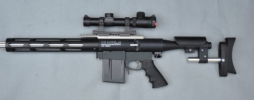

The C.G Model 66 Light Tube Repeater (LTR)
