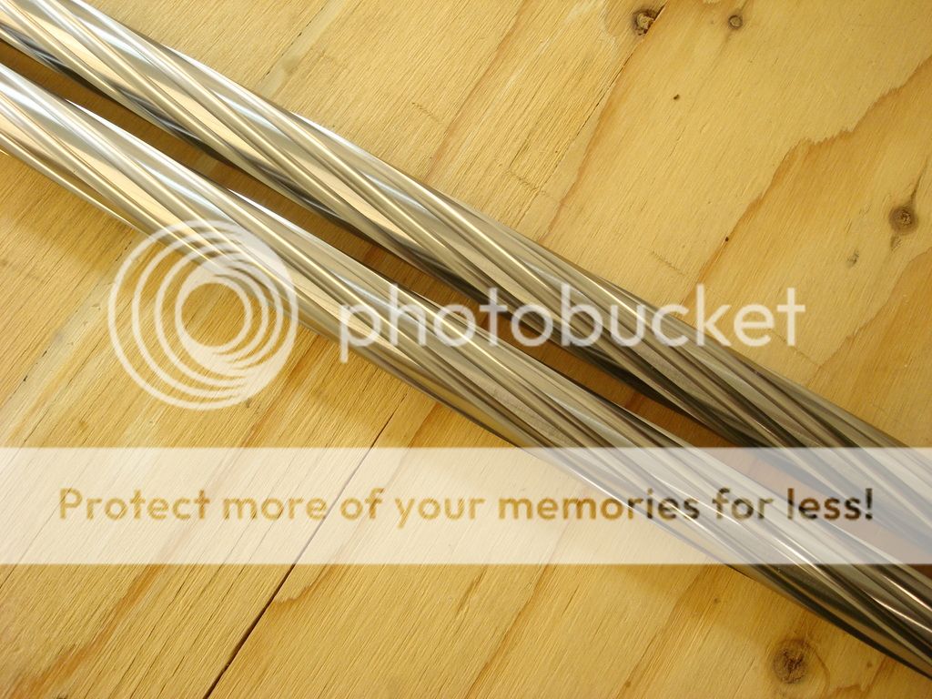

Thought you guys might enjoy a couple of barrels fluted with some new coating technology that I am trying out. These are machined dry at 2750 rpm and 15 inches per minute. Straight off the machine with no polishing at all. Very impressive inserts in my opinion. 8 flutes on the barrels. Normal tooling is run at 538 rpm and 6 inches per minute. Enjoy.:p:D

Hey Jon,
Great question. Based on rpm and feed rate 95% of the heat is transferred to the chip. Chips come off blue and are quite warm. Once the insert and coating reach 1350 deg. F it is self lubricating. The barrel is only warm to the touch. Somebody has their thinking cap on.:cool:

Nice Paul! The great technology race has been going on since my start in the '70's. Tooling and Machine tools. 1000 psi coolant is another biggie in chip management.
I run flood coolant lubricant on both my barrels and tooling. The barrels never get much over room temperature. I make two passes the first is a plunge the second only takes off about .010" and leaves a great finish. The plunge cut is running 230 RPMs with a 2.5" carbide cutter at about 1.0" per minute. The second pass is running about 6." per minute. I do opposing side cuts alternately. Has not had any effect on accuracy.
Exactly.;) Every cut has an opposing cut done at 180 deg. Barrels were polished after fluting and ran true. Just like every other barrel I have fluted. The secret is to make the cuts 180 deg. apart as Rustystud does. Never had a barrel returned for an accuracy problem in 5 yrs of fluting them, so I must be doing something right.:p:D
