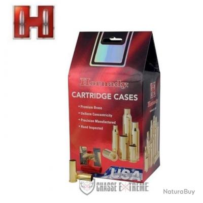

"Did you ever consider using the .300 PRC case for your .338 wildcat?"
Yes, I did for a moment consider it, along with the RCM and the .375 Ruger cases but I didn't want to paint myself in a corner as Hornady is the only manufacturer of all those cases. This plus the fact that the stuff is really scarce and expensive in Frogland, convinced me to use the very common .270 WSM case.

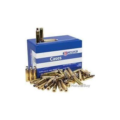

Yes, it's available but quite expensive and you'll never find once fired brass whereas the .270 WSM which is as expensive as the Lapua .300 PRC, is quite cheap and easy to find as once fired brass:
