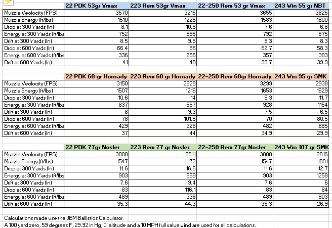

More performance and detailed load data can be had at: PDK20.com. Based on the numbers there, I could gain some more performance if I were to try some of the different powders he has listed. Given the timing of my acquisition of this cartridge, I’ve been limited to trying CFE223, Varget, Acc 2460 and Ramshot Tac.
To put those into perspective, here are the above numbers compared to the 223, 22-250 and 243 (just for comparision). The tables below were generated using my data for the 22 PDK, and the top velocities noted on the Hodgdon Reloading Data Center. For the 77 gr 22-250 load, I averaged data taken from 22-250 Cartridge Guide within AccurateShooter.com. Nosler does not accurate portray their BC for the 77 gr BTHP (they actually are too conservative), so I used the Litz G7 BC. For the 243, I tried to select a bullet that was comparable in design and performance to give the best comparison. Because each of Hodgdons velocities were from a 24” barrel, I subtracted 200 FPS for a fair comparison to a 20” barrel:
2014-01-29
As you can see, the 22 PDK is not far behind the 22-250, and is really in a different class than the standard 223 Rem. It should be noted that the 22 PDK is using about 22% less powder per round averaged between these three specific loads.

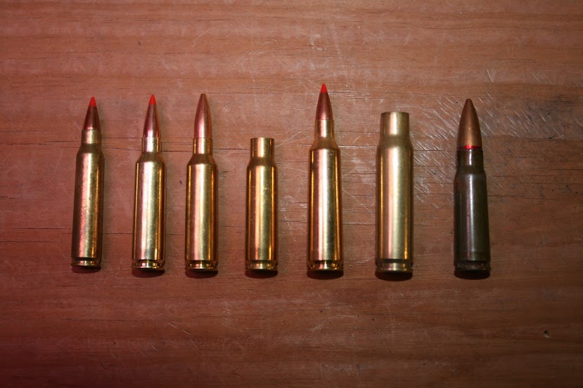

Pics:
Left to Right: 223 Rem (50 gr Vmax), 22 PDK (53gr Vmax), 22 PDK (77gr Nosler BTHP), 6.8 SPC, 22-250 Rem (55gr Vmax), 308 Win, 7.62x39.

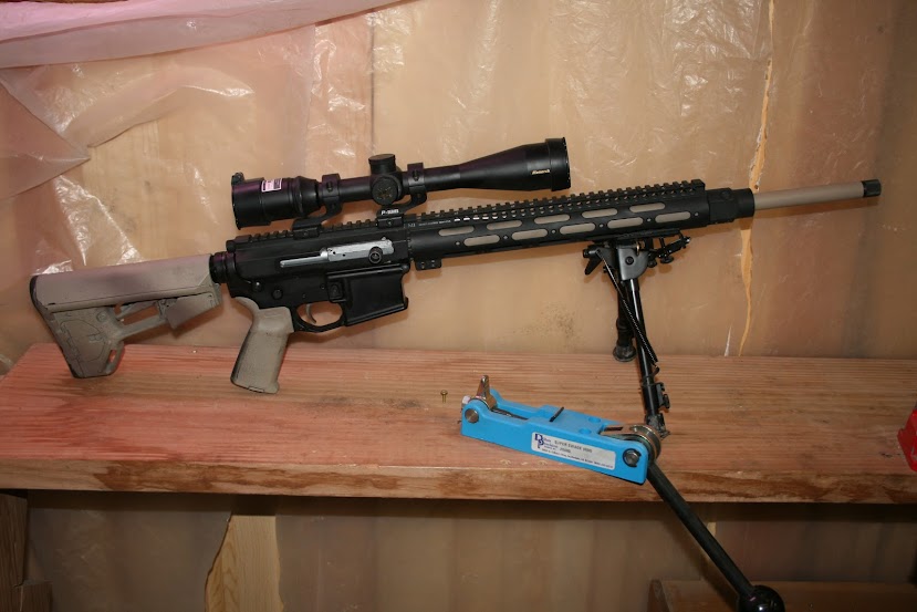

My Rifle:

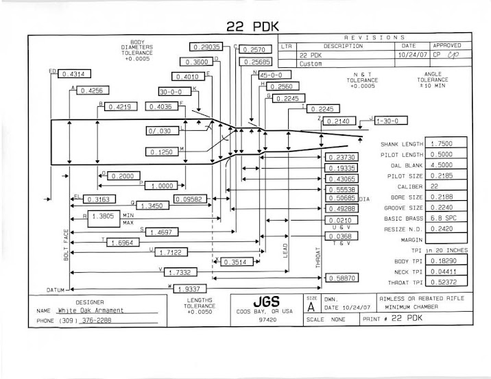

Reamer Print:

Adam is correct. I do have a long throated JGS finish reamer to accommodate the 90 gr bullet that cut one chamber 5 years ago and a sizing die that I will gladly sell to anyone who will give them a good home and would like to experiment.

Reamer print:
