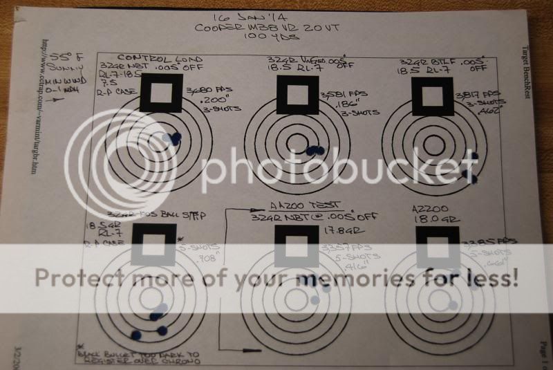

Pacificman: My Cooper 20VT thrives on RL-7, gets right at 3,700 fps with bughole accuracy (usually high ones/low two's) and pure death on sage rats now for three full seasons.
However, as RL-7 is getting like looking for chicken lips, I laid in 8 lbs. of A2200. Yes it shoots okay in the VT, but the accuracy is just not as defined as with RL-7, at least in my rifle.
I only shot a one day test protocol with 8 different powder charges with A2200 using my same seating depth (.005" off), but the accuracy results just did not live up to the hype, nor the degree of accuracy that RL-7 displayed. The velocity was great, hovering at 3,800. Could be this one rifle, but I'm just sayin'....... For me at least, A2200 works, but is not the panacea I had hoped for.
The target below shows my control load in the upper left using RL-7 and speaks for itself (32gr NBT/18.5 RL-7). Note the degradation of accuracy when I switched to A2200 at the bottom set of targets. Keep in mind that different bullets were being tested too.
Not science for sure, but shows the distinct difference between the two powders in my 20VT.
