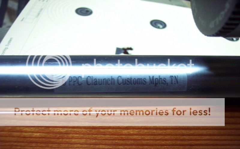

thanx for all the PPC help
I never had a rifle that would shoot consistent in the .1`s but starting with a used rifle from the classifieds here with a Farley action in a Leonard stock,,then a 12 twist Krieger .237 HV bbl from the classifieds here,,and a 35X LCS with raised FCH from Sam Hall from the classifieds here and it all put together by tclaunch an old buddy from tndeer.com and longtime member here then the final piece was the JD`s 68 gr BTs from the classifieds here,,
every piece of this rifle came directly from the accurateshooter classifieds,,plus all the answered questions over the last couple months on how to get the PPC going in the right direction,,
thanx everybody,,I hope to shoot better at Gallatin UBR next Match than I did with the 8 twist 6BR last Match,,
I hope my testing is done and I can just shoot the 29 gr 133 load with the JD 68BT,,I hope that 11 ring just got bigger,,

whatever today is,,I must have been looking at March on calander,,I was really stoked when my first 4 groups with the new bullets looked like that,,I dont ever remember shooting sub .150 groups back to back,,hopefully it will do that 4 times in a row with all 20 loaded the same,
but I really hope it will eat the crap out of those 11`s on the UBR target,,

shot 20 rounds this AM to confirm the +.010 seat depth,,after that went ahead and loaded 100 rounds and gonna shoot some dots across my flags next few days and get used to the effect the wind has on the load and hopefully be able to shoot the Match with this load as is,,
agged a .190 in pretty calm winds but mirage was tough so I am pleased with the load and the rest will be on me,,with the bullet holes overlapping and no holes in any of the groups hitting the 11 will be all on me and my weak wind skilz,,
thanx again for everybody that talked me into using the 12 twist when I ordered the 14,,I just almost used it for a zero freebore 6BR and made a varmint rifle with it,,

I have been shooting for 2-3 weeks in different conditions and it seems like 29.0 is in the middle of the node ,,it seems to shoot the same groups and POI from 28.5-29.5
