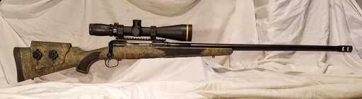

I have a hunting stock that I'd like to try a to coat with a spray can. Any recommendations for a decent rattle can textured spray paint? (Or as good as can be) It's a composite stock. The sharper the edges the better. I like tan for this or I might consider spray bed liner or under coating or??? Haven't see those in tan though.
Thanks
They look dipped. Very nice!
I’d be tickled if mine turned out like that.
A tan marble would work. Trying to match the southern winter Bermuda grass here.
What bottom metal is that on the top rifle? Is that a sako or tikka?
