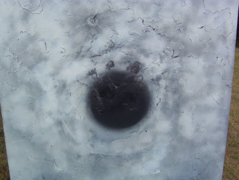

My ballistics program showed that this load should run about 2700 fps, so I dialed in 15 minutes of elevation for 600 yards and fired a few shots. I could hear hits, but couldn't see them. I added 1 minute more and fired 1 shot and saw the hit. Dialed back down and fired the 5th shot.
As you can see, less than 1 " of vertical at 600 (not counting the one) not too bad at all. The same accuracy was realized at 800, 900, and 1000 yards.

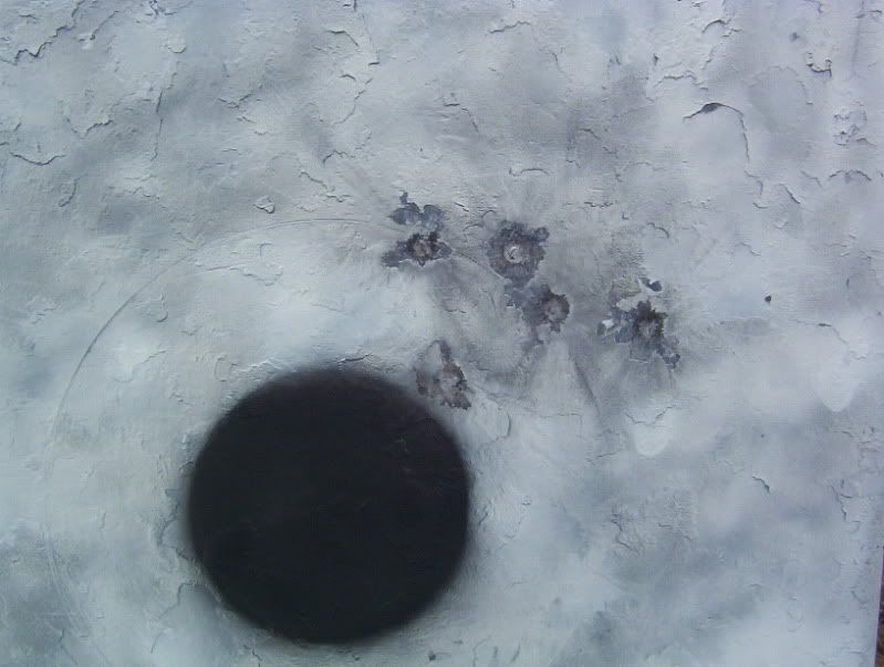

This was at 800 yards. The 900 yard group was similar, but I guess I moved the camera before it captured because all I got was grass. LOL

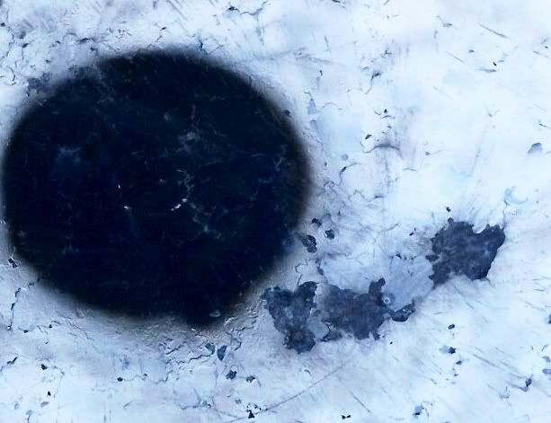

This is the 1000 yard group. Yes, there are 5 shots there. BTW, the black area of the targets are 1 moa. I will be ordering more of these when they become available.
