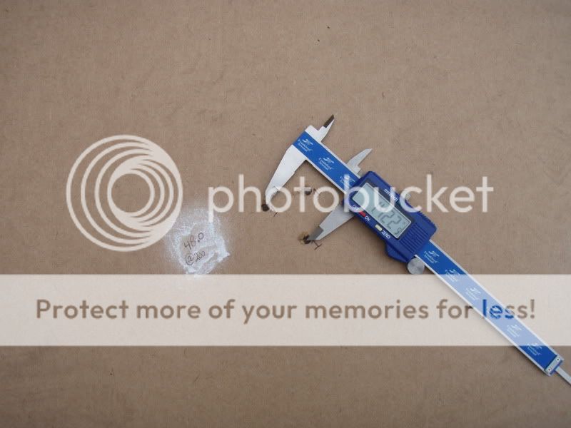

Terry , I have no trouble with this 49.0 load of RL17 . after adjusting case capacity on quickload I'm a grain or two over quickload max . I've shot this load in the summer heat with no problems and I get good brass life using norma brass , so I'd say I'm safe with it . but as always start low and work up .
here are close ups of the big cardboard target that I posted in my first reply . these are the three groups across the top .
48.0 grain at 200 yards (left )
48.5grain at 200 yards (middle ) I always had one out with this load . don't know if it's me or the load .
49 grains at 200yards ( right )
http://i106.photobucket.com/albums
/m257/jimmyboy16866/targets/P8140530.jpg
here is 49 grain at 100 yards
