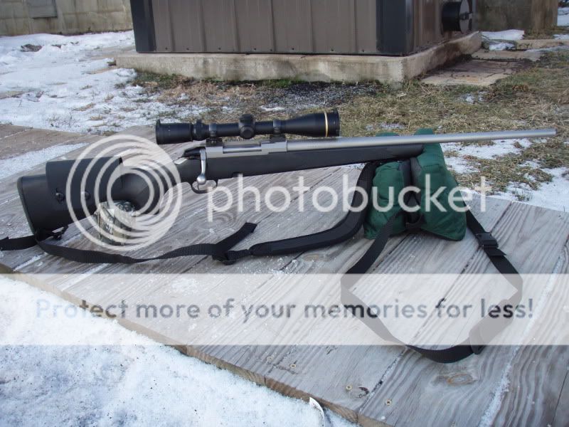

My favorite rifle. Remington used to have a Model 7 stainless with black tubberware stock. Dad gave me one when I turned 16. When I was 25 I didn't want to change the rifle but wanted more accuracy so I updated everything without really changing the ergonomics or cosmetics on the rifle.
Now has black HS sporter stock
Hart barrel #4 contour at 20 inches. Bead blast matte finish stainless
PTG hinged floor plate
Adjusted factory trigger
Got rid of the J lock
Shoots 1/3 moa.
Handy for Southeastern whitetails.

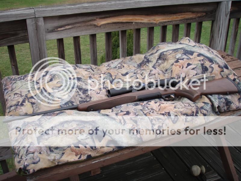

Terry , I have 3 of them . I've hunted whitetails with a 595 tikka for probably 10 + years . so when my girlfriend wanted to hunt with me , I bought a browning X-bolt for her . I also have a rem 700 that has a trued action with a 24" broughton bbl McMillan bedded stock . I find the 7-08 pretty easy to get decent accuracy with .
my Tikka is all stock except for me adding a cheek piece . I use IMR4064 powder , cci200 primer , hornady 139 BTSP , and any brass I have available . it's a hunting rifle and it shoots well enough for that .

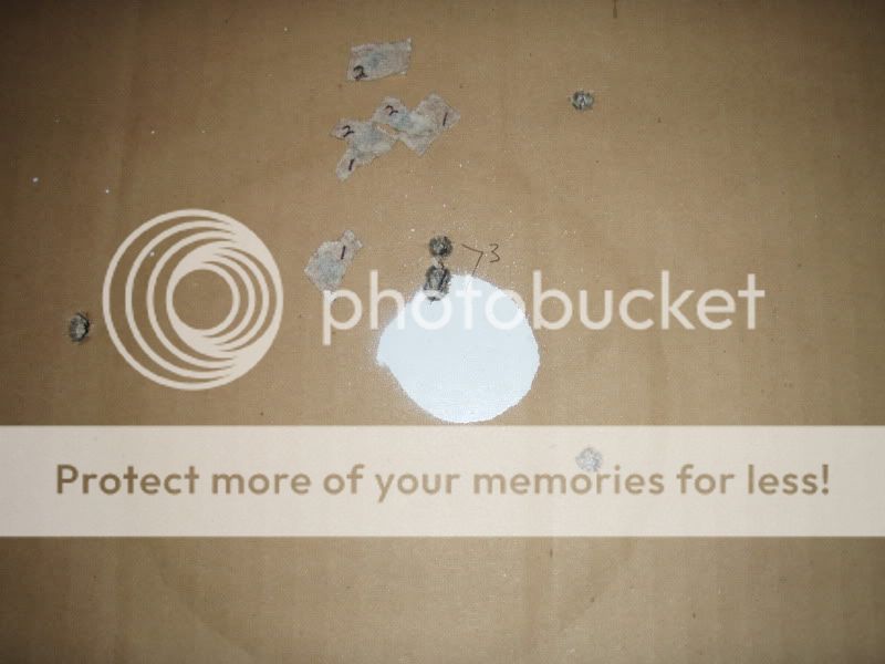

the big center group is 200 yards .the taped over holes were old from a different day or maybe a different rifle .
100 yards . sometimes it will shoot like this , but not consistently by any means . the three wild ones are me shooting off hand .

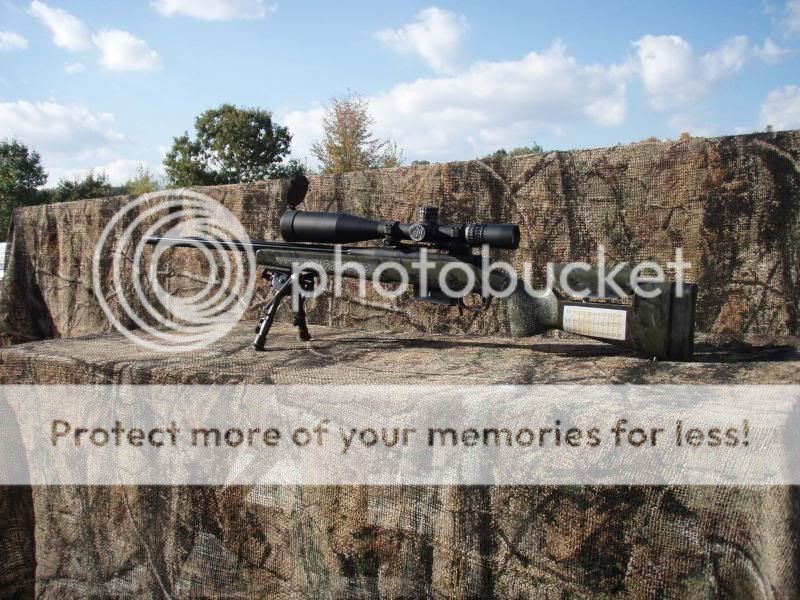

rem 700 . I'm using RL17 powder , cci200 primer , berger 140 hunting VLD , norma brass. some of these targets would be shot prone with a bipod . others from a bench with sand bags .

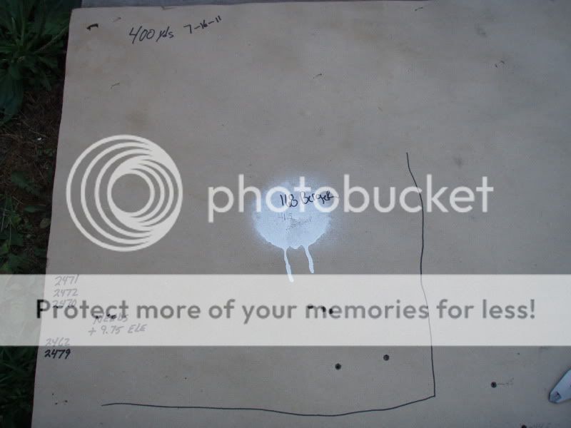

200 yards . the top three spots are from this rifle .3 different powder charges . left 48.0 , center 48.5 , right 49.0 . I always got a wild one from the 48.5 load .
I played with berger 168 gr hunting bullets for awhile . I just don't think the 7-08 has the case capacity for this heavy of a bullet .

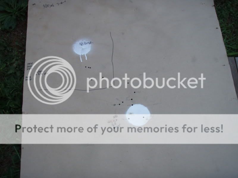

400 yards . I think this was the day I couldn't see my hits . after I walked out and saw the first 3 , I fell apart . I couldn't put the other 2 in the group .
same target with a ladder test .

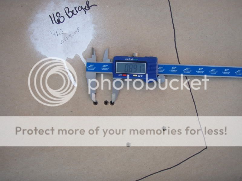

same target with a measure.
