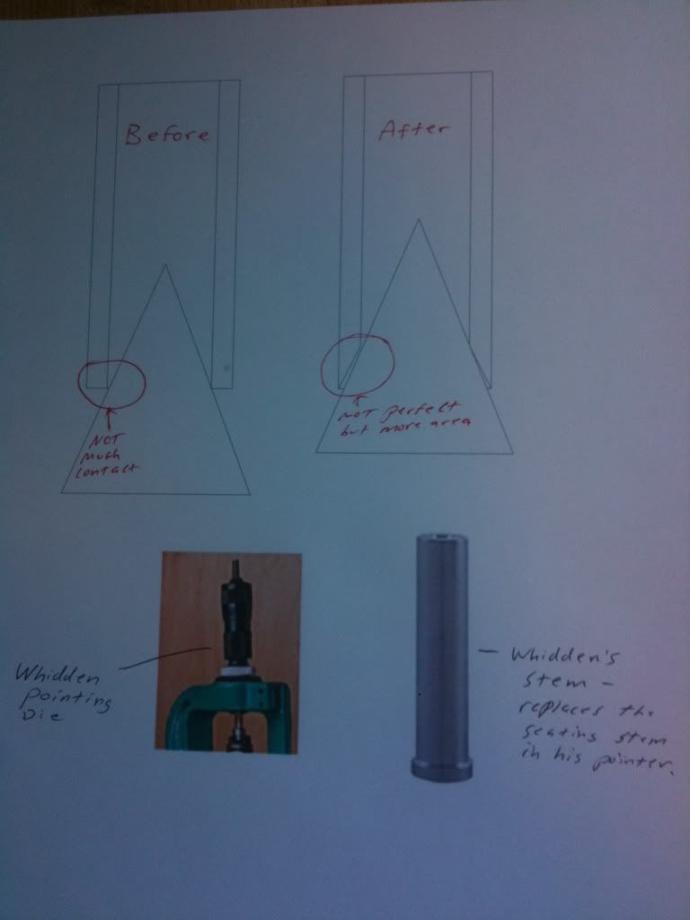

Wayne, Boyd, et al; I found the seating stems in the Redding Comp seater had such severe angles at the contact point it was leaving a ring on the brass were it made contact, even with very little neck tension.
What I did was to use a Dremel tip that was as close to the ogive shape as the 6mm Bergers and very gently chamfered that sharp contact edge away. The pressure is now spread over a larger area. It hits a little lower on the bullet, closer to the land contact-point.
Forgive my crude illustrations but you get the idea.
I think that boring out a solid stem, say a little bigger than what Whidden uses for his Pointing Die, to the exact profile of the Hybrid or VLD would be the best solution for the sliding sleeve Redding Comp Seater.
This still doesn't address the issue of our measuring at points which aren't the "real" contact-points; Stem/Comparator contact point vs Barrel Lands contact point. Don't know what, if anything, we're giving away in that respect.
