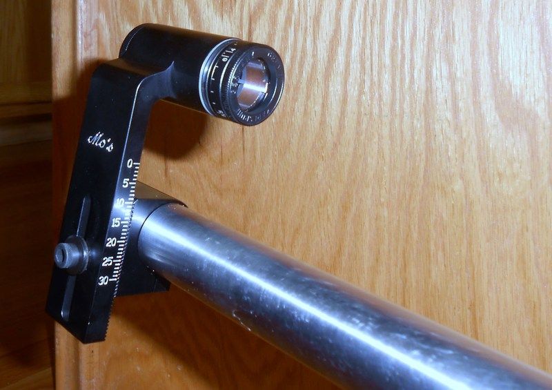

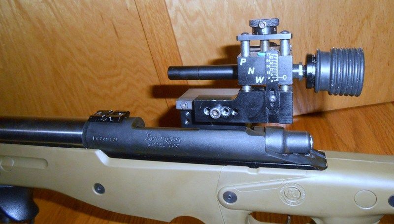

champions choice has adapters that bolt to a pic rail that take Redfield type mounted sights,,I have a PNW on mine but also have a Redfield Palma on a smallbore that seems to work just as good,,,,I used the Mo`s front sight tower with 22mm Centra 4-6mm iris and .5 diopter,,banging 20 inch steel at 1,000 just for fun is not that hard and have actually hit a 10 inch plate a few times,,rifle is a 6.5x47
sights are mounted so high to work with the AICS 1.5,,
You grt what ya pay for
this is true no doubt,,I like the PNW for my use but the Centra and Warner may be better IDK,,but with the Mo`s front it adjusts 5MOA per notch for getting close and the PNW rear has 1/4 MOA clix and 3 MOA per turn and it tracks better than a lot of scopes with no backlash or dead clix,,
when zeroed at 100 yards my front is on line 14 and to move to 1,000 I go to line 9 for 25 MOA and then only need 8-9 clix on the rear to get on at 1,000,,the Gehmann iris allows for focusing to the light conditions with pretty much none loss of zero,,
I have thought about a .75 or 1.0 diopter for the 10 inch plate at 1,000,,I cant do it without anything and can just barely see it with the .5 but I can and with the front closed up to 4mm I have hit it 5 times in a row,,

when I first set rifle up for sights I had a 3 inch wide plate bolted in the rail for the handstop and was shooting it off a rest to get my dope and check to see if everything tracked as it should,,I can tell you for sure the Mo`s front sight adjusts as good as the PNW rear and is much easier to get 25 of the MOA I need by moving it down 5 notches than it would be to twist the knob on the PNW almost 9 full turns,,
Tim Claunch did all the work on this rifle also and turned the mzl down to .750 to use the Mo`s front sight,,barrel is a Bartlien 8 twist 5R on a Rem700 PSS action with bolt bushed and pin turned down by Greg Tannell,,
the sights are repeatable enough I can take them off and mount a scope and put them back on and be within an inch of my zero at 100 yards and most times it will be dead on,,

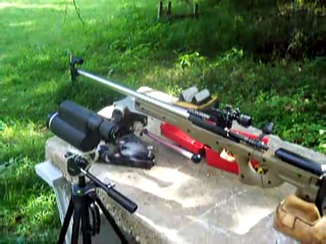

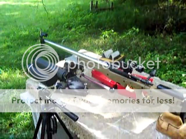

a clip of the first 5 shots I tried at the 15 inch 1000 yard steel plate,,4 out of 5 aint too bad.
click the pic to play video,,camera sux but you can get an idea,,
