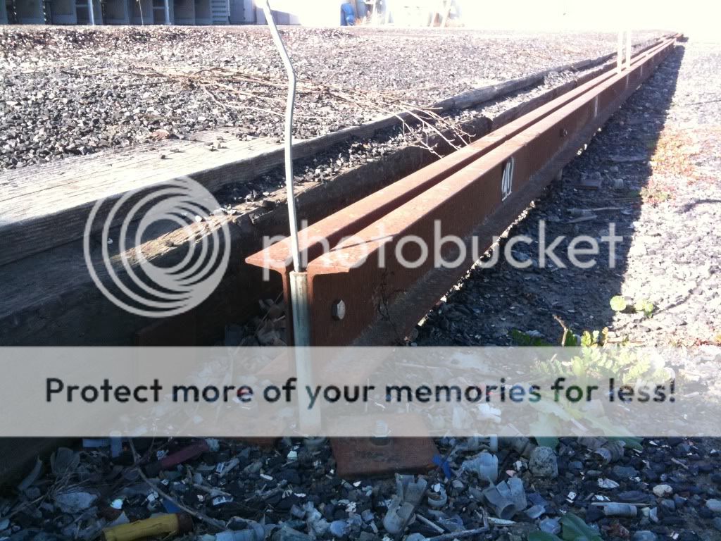

We have target lines at 25, 50, 100 and 200 yards downrange from the shooting line.
The shooting line is about 75 yards across - we have twenty covered bays.

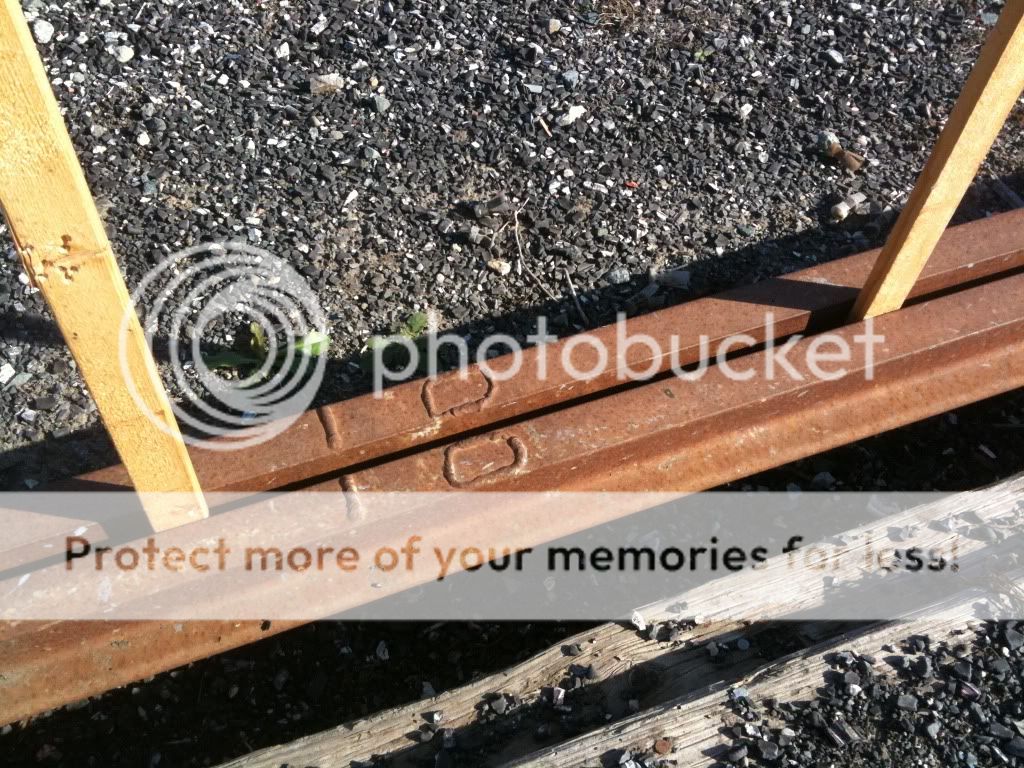

At each target line we have two lengths of heavy (10"x3"x1/2") iron "rails" lying parallel to each other that lie across the range. There is a small slot between the faces of the rails into which the target stand legs slip. Target stands are 2"x1"s, with a center of 36"x36" to hold a cardboard backer to paste/tape the target to. The two outside frame parts are 6' long and slip into the slot described. The rails do not sit on the ground but are raised 6" and are somewhat recessed into/behind the gravel & crushed clays range surface.
This leaves room for rocks and chunks of clays to not get stuck in the slot while the target stand legs fit between the rails, fairly snug, and hold the frame upright even in wind.
Photos added 12-8
Great set-up, Scott. Many years ago when we only had a 100-yard range we had a similar set-up. Now, though, we have multiple yardages available all from the same shooting line. So any permanent target frames will block all those behind them. Thus, a full-width target frame at 25 yards would block the ones at 50 and 100.
Our users pick up a target frame (like the one in the post from killshot above) and place it at the yardage they want to shoot at. Sometimes at 25 for a boresight, 50 for a better zero, then at 100 for sighting in. There can be a dozen or more shooters at any given time on the weekend shooting at all distances simultaneously.
