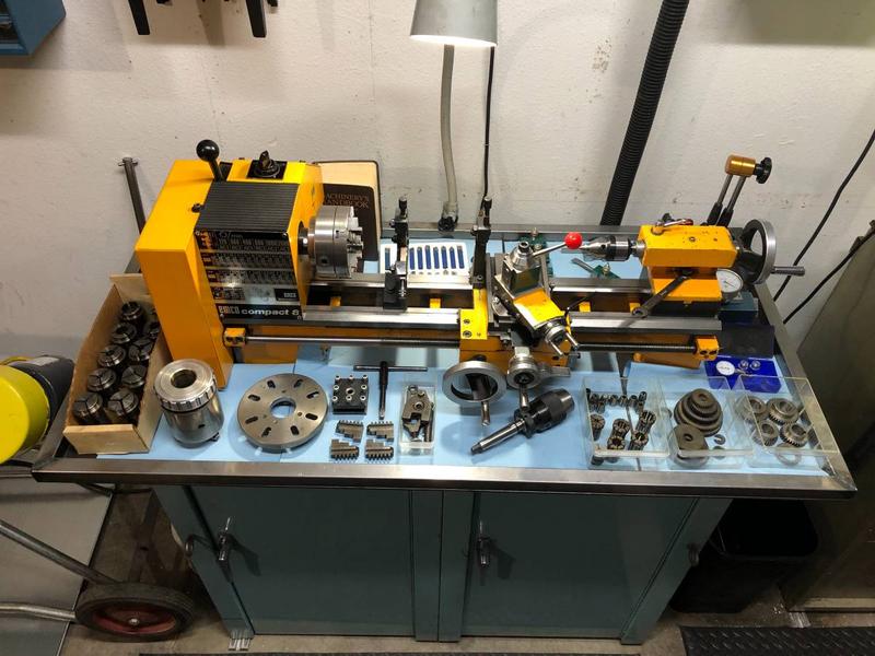

EMCO (not enco) makes a mini benchtop lathe and (separate) mill, being that they're made in Austria they are not inexpensive. Overkill if you're trimming brass necks.

For a small benchtop lathe the EMCO depicted above is the best made and can deliver the most precision of lathes in it's size range. It will cost a bit more than the asian imports of the same capacity but the quality is unparalleled. After owning and/or running several lathes from a 12x36 Enco up to a 15x60 Clausing/Colchester if I were to get a 'hobby' lathe the EMCO would be it.
