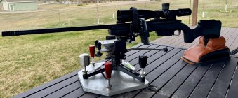

Thank you for the offer! I ended up building my own coaxial rest with a little redneck ingenuity :)
5 point leg contact thru a 3/4” thick aluminum plate i cut and threaded myself. Used weighted automotive manual shifter knobs on leg tops for easy adjustments and added weight. Shadetree coaxial top I modified with a custom bent stainless steel tube handle and knob. All 3 legs of the coaxial rest are filled with lead for added weight and securely bolted to the base with threaded holes. Bent the main rough elevation pillar locking bolt handle for greatly increased leverage when locking/unlocking. Bolted and welded a custom spacer and dual post battery stop. Touched it off with a high quality aluminum level and it all works amazingly well! :)

Yeah thats why i built a coaxial rest with a long handle
