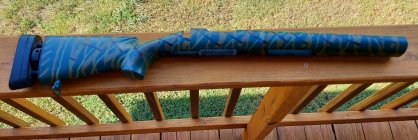

Synthetic stock but who makes it and what action? UPDATE !!
Got a stock that have no idea make or which rifle. A rem 700 bdl floorplate fits it but not the action.
UPDATE!! i finally found what this is for a M24 replica airsoft online and thats what this stock fits. Yea i feel foolish now.

Figured it was custom as i never seen this type of inletting with extra slot. almost looks to hold spare clip or something.

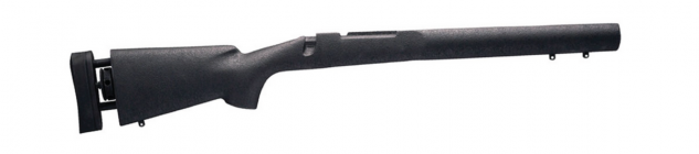

It looks like an HS Precision adjustable M24 stock that has been modified at the forearm.
When i actually seen it at first that was my first thought also. But even the size of action screw holes are smaller than the 700 action screws. the space between screws is correct for the 700 sa. the hinged floorplate from 700 sa will sit right in snug but lug location is all wrong

I got this just gonna use on a 700 build until permanent stock came in. All i had was a few pics and action screw measurements to go on when purchased. I thought it was an old M24 stock modified with extra slot. But not sure now what action it was for.
Thats what i thought also but 700 short action will not sit in stock. Too narrow and action wont sit all way down. Also lug is set back too far. And does not look to been bedded or filled in where action sits. Even back near rear action screw is weird cutout?
To be able to free float the action, The inlet will not accept an action, Otherwise it would have way to large of gaps, That's why a Remington 700 won't fit in it the way the stock has been made.

Ok guys i feel foolish now as i think i finally found online what this stock is for. And this probably should not be posted here i dont guess being its for airsoft. LOL Airsoft M24
