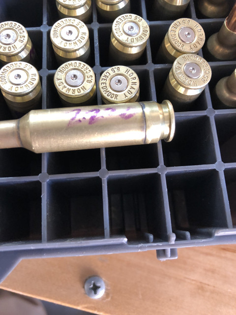

So I had this happen today on 3x fired Hornady brass and it's unsettling. Most of my rifle reloading has been for .308 where I used standard dies RCBS dies. I never turned necks, used an expander ball, and FL sized only bumping the shoulder back .002. I had 500 pieces of LC LR brass that was primed and never fired. All that brass has 5x on it and I only have a few loose primer pockets. It shot a legit .5 MOA consistently although everyone shoots that on the internet these days.
The Old Ghost Thomas Lovell Beddoes
I'm using basically the same standard FL sizing die on the 6.5 creedmoor along with a Redding competition seating die because the micrometer makes this simple. I'm still only bumping shoulders back .002 but apparently I'm overworking the brass so I was thinking about switching to FL bushing dies. Lately it seems like the expander ball requires more force to be pulled out of the case. I can only assume that the neck is getting sized down too much.
So with bushing dies I'm figuring the best practice is to decap the brass separate and use a bushing .002 smaller than a loaded round. The question is if the bushing sizes the neck with the right tension why are some people using a mandrel to expand the neck?

i check every firing. I know sometimes the brass won't fully form to the chamber after the first firing but my measurements (shoulder) always come back 1.556 using the Hornady kit, forget what it's called comparator? They didn't have the RCBS precision mic when I got the gun, but that's what I use in other calibers. First, second, third firing all the same.
I just took a bunch of measurements on the neck, base, and body of the brass to see how much the die was sizing down. I first removed the expander ball and the body that measured .464 only went down to .465.
The neck sizing however went from fired- .295 / resized (no xpander ball) to .280 and the expander ball opened it up to .286

Have you checked to see how much your die is sizing the body? I would be measuring a fired case before and after sizing in the area where the separation happened. Hope you get it figured out.
Hornady 6.5 Creedmoor cases with case head separations are about as common as photoshopped ladies on the Internet. I literally see someone post about it very regularly. The solution is to buy better brass...
It might seem like it costs more, but when you can fire it 20 or 30 times it starts to make sense....

Fired, unsized brass measures .465. Sizing it brings it down to .464 a reduction of .001.
Now I'm reading that people are getting smaller neck OD than the bushing size. Redding says this happens when you're attempting to size over .008 going from a fired .295 to .286/.287 tells me I'll probably experience the same problem.
