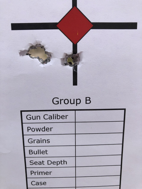

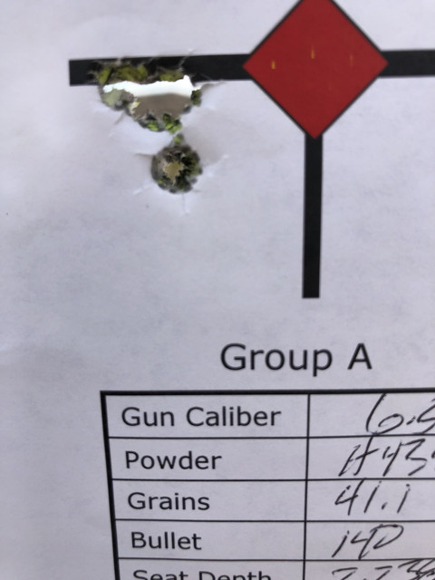

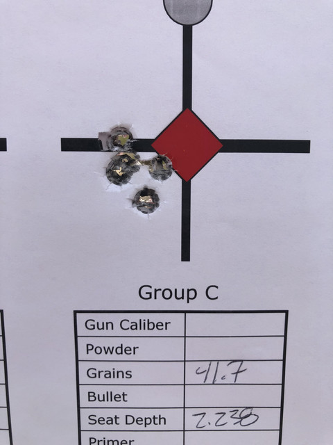

Fact is a lot of load data is universal. Why do you think some match grade ammo works so well in so many guns? Federal GMM is .308 or Hornady 140 ELDM. My old .308 load worked well across multiple 308s. I get the fact that you have to cater to the lowest common denominator around here. I ran a test starting .5 less and pretty much nailed it. 41.1 and 43.4 both shot well and the error in the second group was a called, pulled shot. So I'm going to load in the middle to account for any variance in the chargemaster. They started opening up at 41.7 I loaded higher but didn't shoot any of them. 43.7 was getting close to 2800 from 2776 to 2795.
