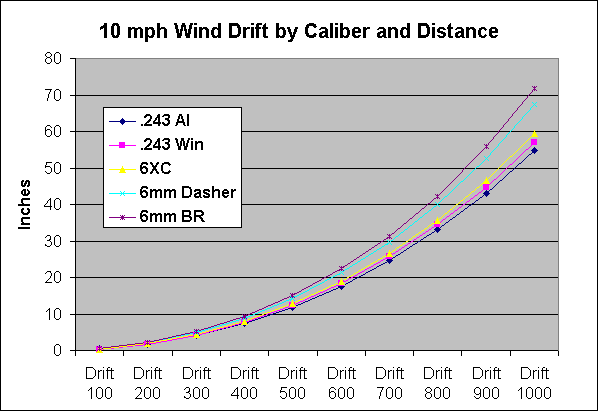

The first thing that the Form Factor shows is that the Berger 6mm 105 grain Hybrid Target is pretty darn good with a Form Factor of 0.925. It is notably better than the 115 VLD. So one option is would be to stay with the 6mm caliber, and consider a large capacity case which will give you more velocity with a sacrifice in barrel life. The 6XC would be a significant step up, and the boring 243 Winchester another smaller step. Brass is available from Lapua (neck up 22-250 for 6XC). Here is a graph from elsewhere on the Accurate Shooter site to give you some rough comparisons. There is also the uncommon 6mm Remington which has a long neck and even more capacity but brass could be an issue.
