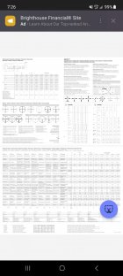

Unfortunately it is not possible to change the turret to MOA system. See enclosed technical data.
