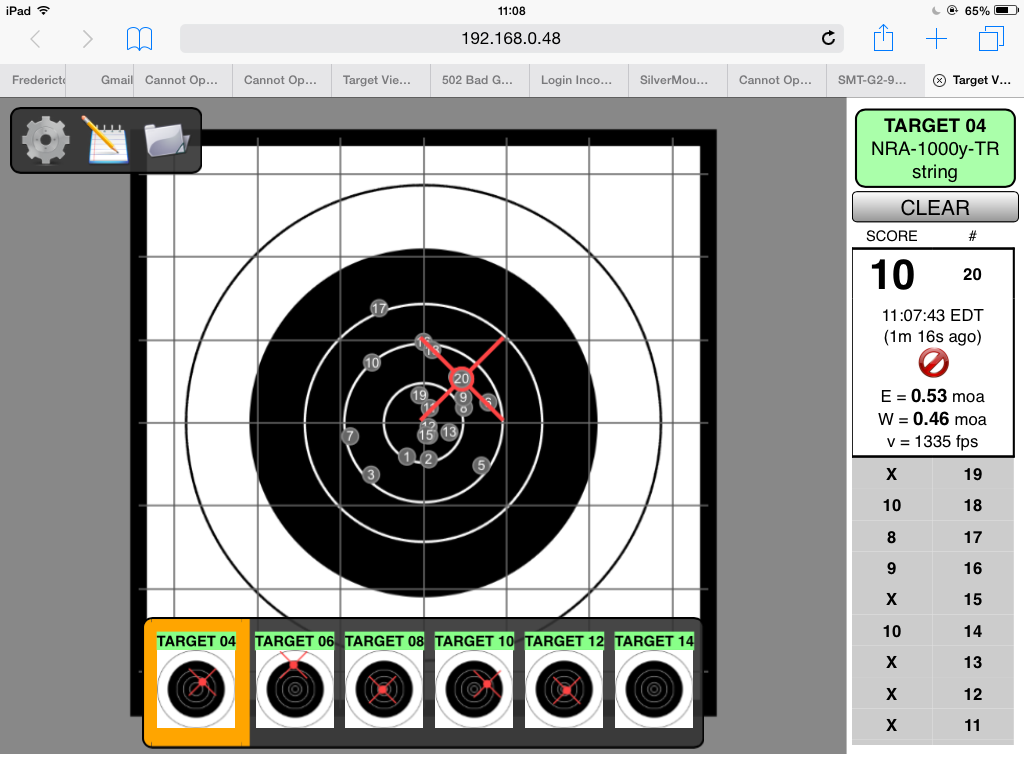

Here is a screenshot I took during a 1000 yard match at the beginning of March in Blakely, GA This shooter has finished firing his string on target number four:
image by Daniel Chisholm, on Flickr
What you can also see is that the most-recently fired shot on Target 6 went high, number 8 has a center-X, number 10 is a bit to the right, and number 12 is pretty central. In this particular case there isn't any particular trend or useful hint/warning being told by the shots on neighboring targets, but in other cases there might be something that might help the shooter avoid some lost points (maybe a few of the others lose their shots upwind, for example).

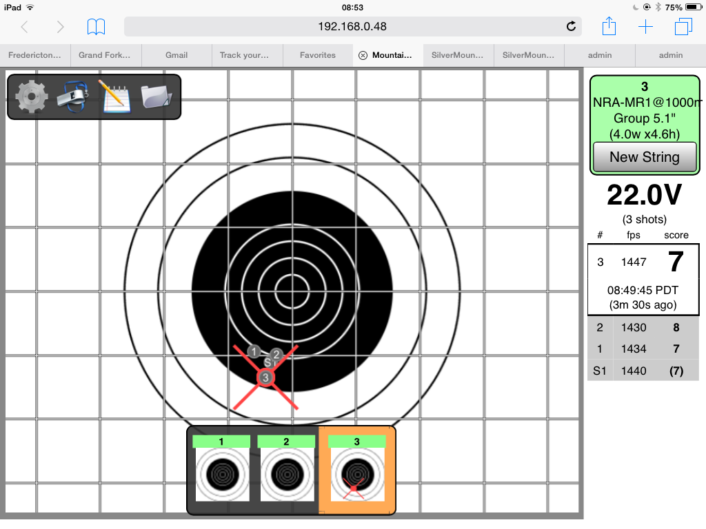

Here's a newer screenshot, taken last weekend at a 1000 metre benchrest match in British Columbia:
This match was fired on the NRA 600Y target but at 1000 metres (approx 1100 yards) so the one-MOA grid marks look pretty coarse on the target face!! I think this was the winning group fired in the Hunter Rifle class, from a Tikka 7mmRemMag firing Berger 180s. Here you can see that we are displaying the total score and group size. You can also see that his sighter shot is identified as "S1", and while it is shown to the shooter it is not included in the calculation of score or group size.
