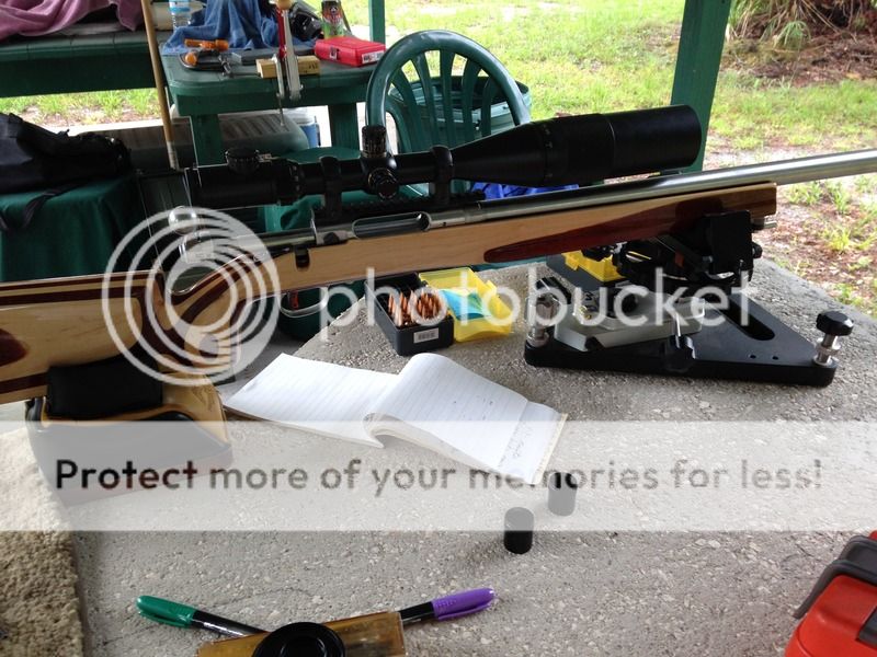

Was told my new Stolle 6 Dasher would not be ready for months. So, with new Krieger barrel on my Savage action I go out and work all day yesterday. Found the right seating depth (.014"), right tuner setting and made numerous nickel or smaller sized groups at 200 yards.
This is at a private range I begged permission to use. Set up a portable press and did my loading work right at the range and all by myself. At just 302 rounds through the barrel I got it and got it right for next week's shoot.
