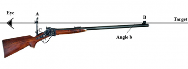

Remember the movie "Quigley Down Under? The character Quiqley used a vernier tang sight with increment marks of .05". Notwithstanding sight radius, that translates to 5" at 100 yards; subdivision on the "slide" gave precision to 1" and guesstimation between marks offered 1/2" SMOA. It's what technology offered at the time. I have vintage Lyman Junior and Super Targetspot scopes, with external mounts, in SMOA, precision to 1/4". Other than vintage and reproduction iron and optic sights, SMOA is not often encountered.
