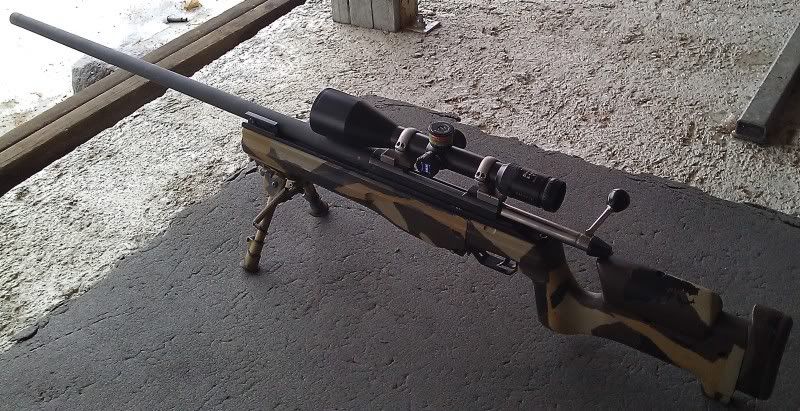

Any gunsmith worth their salt should be able to whip up a custom bottom metal for you and you could maybe run AIAW magazines. But; If you want ready-made parts and you're willing to go all the way financially, call a Sako/Beretta dealer and try to get a TRG-42 chassis and stock, along with the trigger group and magazines. That's what I did, well, except my stock parts are actually from a TRG-41 but apart from some external dimensions (pistol grip angle, cheek piece width etc.) they are identical.
Can't make any promises as for the parts availability though, here in Finland these things float around second-hand every now and then so I honestly don't know Sako's policy on TRG part sales.

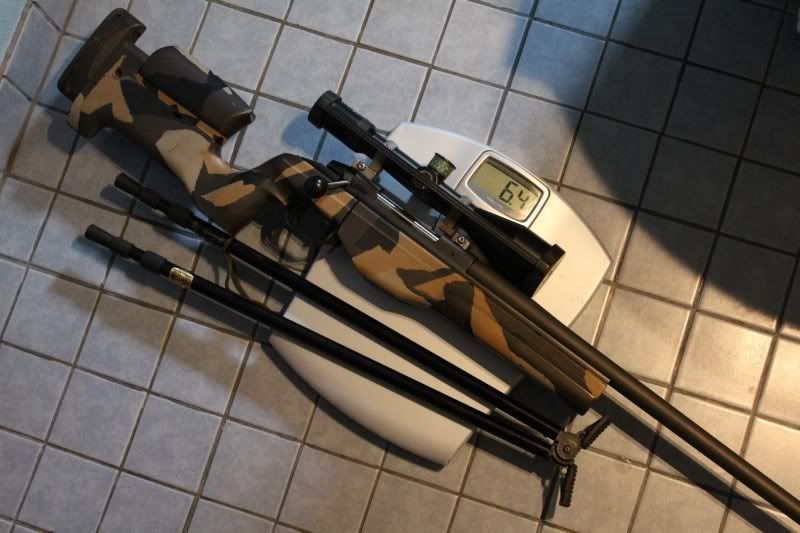

(the scale is showing kg's, by the way. Thats 14lbs including the Stoney Point)
