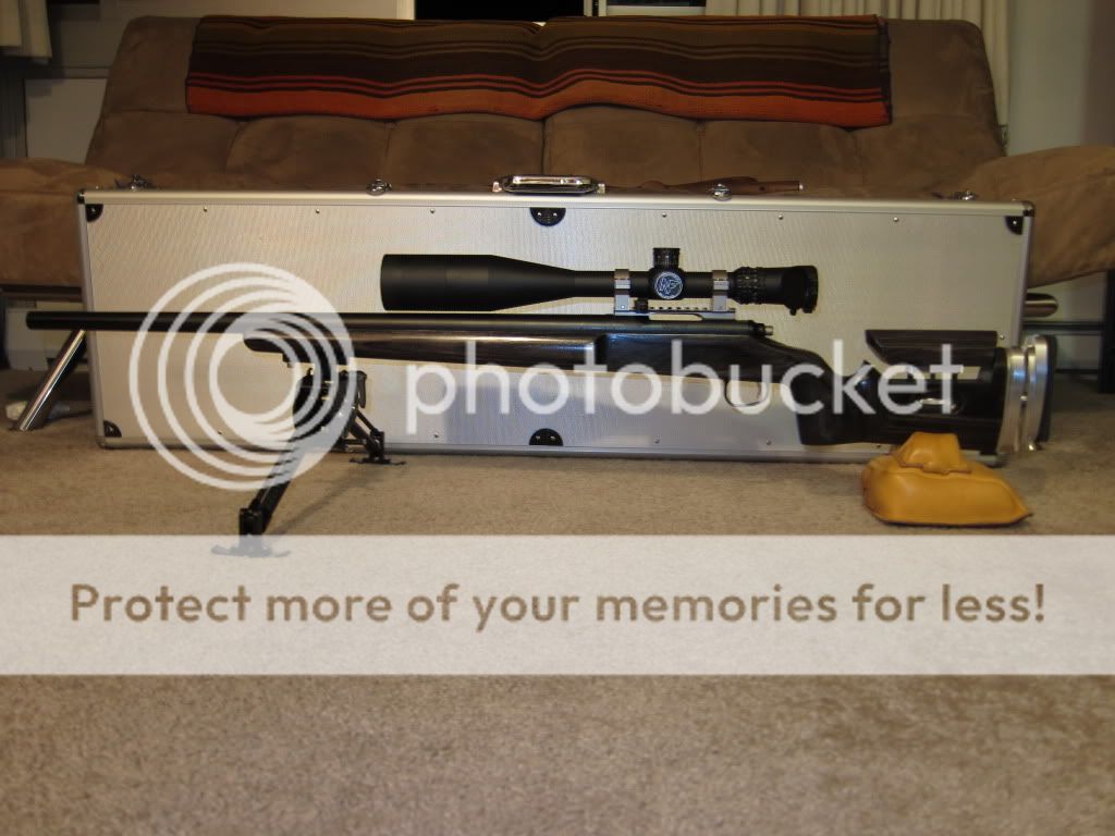

I am using a Precision Rifle & Tool F/TR stock, I cannot say enough good things about it. Because of the weight limit I suggest you decide well in advance what exact components you are going to use. I am running a Rem 700 action, 28 inch AMU contoured barrel, PRT stock with one of Alex Sitmans 3 way buttplates to save weight, a Centershot bipod, NXS 12-42x56 in Murphy Ti rings and bases. As it turned out I have enough weight to spare that the next barrel is probably going to be around 32. The long forearm on the PRT stock is deceptive, most folks dont realise the barrel is that long.
