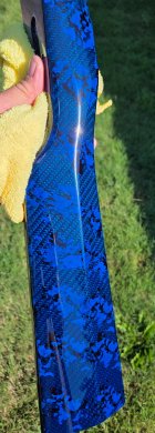

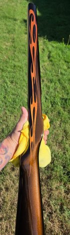

Here's a sample of some stocks shipped this month dyes, candies, automotive colors and just clear.
Dyes with candy 2 colors
20250708_164023.jpgjust black n blue dye20250707_164832.jpgstencils with automotive colors 20250626_091811.jpgsponge painted with automotive and sky blue candy20250626_092316.jpgjust clear20250619_211112.jpg
Feel free to give a holler, and yes I make it look easier than it actually is.
