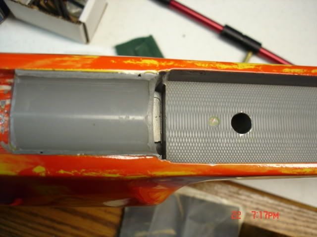

Barrel is a kreiger #17 maxed for williamsport,0.950 at 29") instead 930 or 940 that the contour calls for.
Dont know of the stock you speak, the one in the pic is a tracker MBR from SHehane.
Contrary to convention, i bedded mine about 3" ahead of the recoil lug:

I havent seen a quantifiable difference except wood, EVEN LAMINATE has the propensity to WARP!
YMMV,
