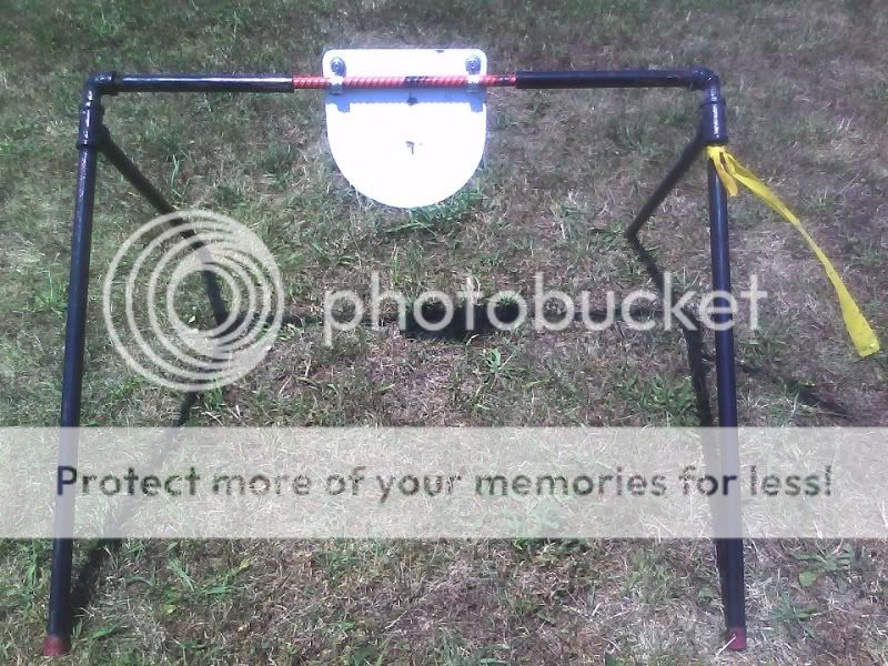

Steel hanger V3 & 6XC 500 yd groups
Rifle: Savage Target action, 6XC, 28" 8 twist Criterion barrel
Scope: Sightron SIII 10-50x60 target dot
Loads: Norma brass, 105 AMax hBN coated, 215M primer, 39 gr RL-17, seated .010 & .015 off lands, 3100 MV

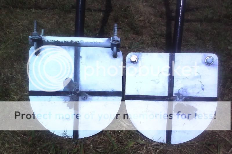

After finding two loads that looked good at 100 yds, I decided to shoot them at steel at 500 yards from my portable bench. Both three shot groups measured 1.25" or .25 MOA. I chose the load that shot the steel on the left in the photo which is .010 off the lands.
The right steel target (back side shown below) is my version 3 of a steel hanger. I used 5/16 bolts and ordinary conduit clamps then slid a 1/2" rebar thru the clamps. The setup showed no ill effects after hitting the steel three times with 105 grain bullets at 500 yards. The steel tilts slightly causing the bullet splash to be directed downward.
