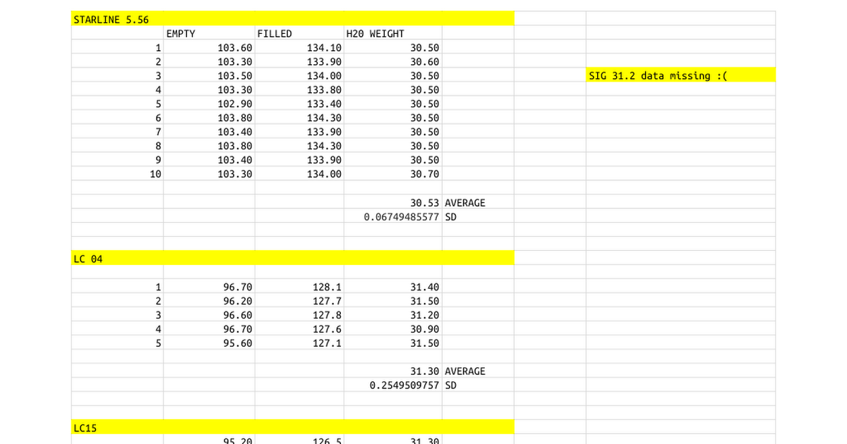

I added Lapua 223 to my chart. Going to be a lot of upset boomers on this one guys. Lapua measures up pretty average compared to LC and other common brands.
Except for Starline, which comes in at less than half the SD of any other brand, including Lapua.
Good stuff.
I graphed your results and it shows the typical weight v volume relationship of 223/556 brass.
