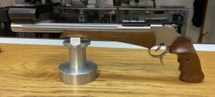

Left to right
300/221RIMMED from DW360 brass with Nosler 190 Custom Competition, 30Reece from 357Mag with SR 180 MK, 7 Dragonfly from 357Mag, SR 168MK, 30-20 from 32-20 brass with Hornady 155 BTHPView attachment 1641884
Melvin, how long have you been shooting a 30 Reece? I met Carson last year at a little shoot gathering we usually have once a year. He’s known the other fellas I shoot with for many years. I even got a set of dies from Carson a bit later, but haven’t gotten a barrel yet.
Probably 4-5 years. Carson is a nice guy. I’ve bought a couple sets of dies from him. He even sent me some Hornady 30 Reece head stamped brass. It was not formed, just the straight walled cases.
