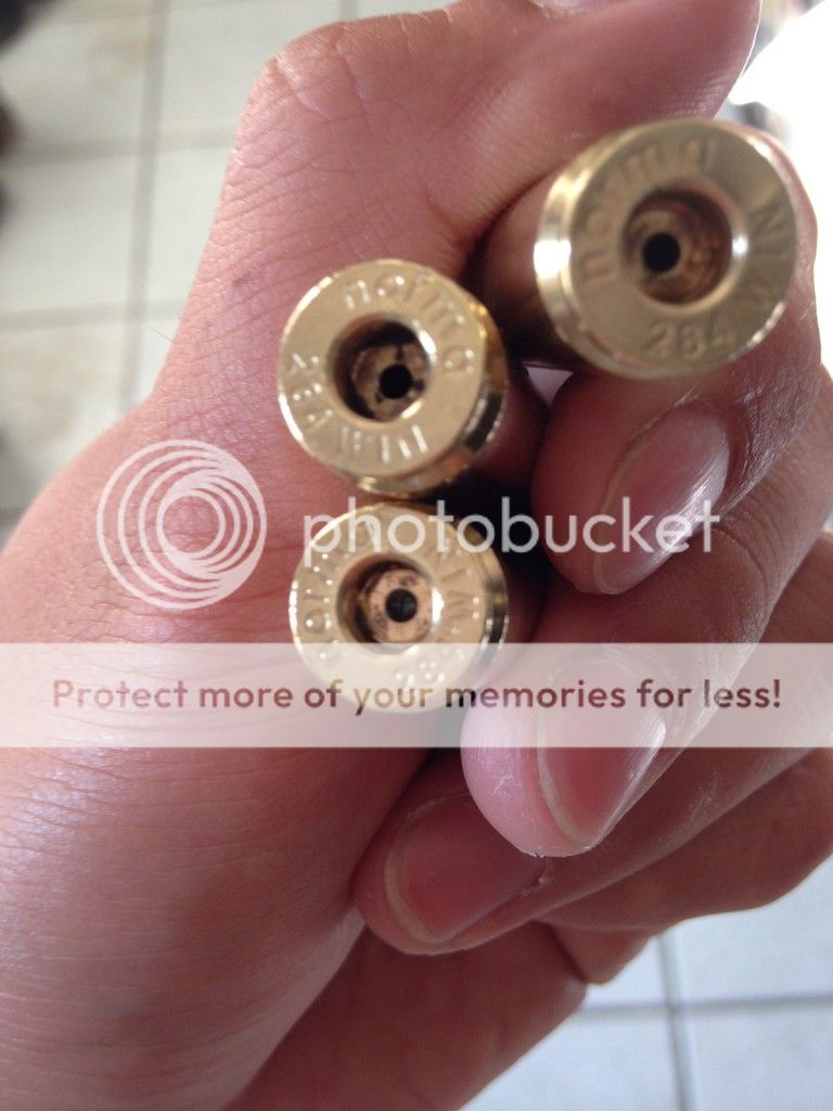

50 cases, deprimed. 8lbs SS media. 2.5 Hours.
Tumbled longer than usual on this batch. I'll try it again to your specs jlow and maybe post results.
Peening is present but hard to see on picture. It's more that the case mouths peen inwards and require a chamfer than needing an outside deburring.
Time is a huge factor, try the 1 hour and see how it works for you.
10-4.
I've found with 1 hour the brass is shiny. There will be some residue in the primer pocket, but a lot cleaner than several hours using traditional dry media.

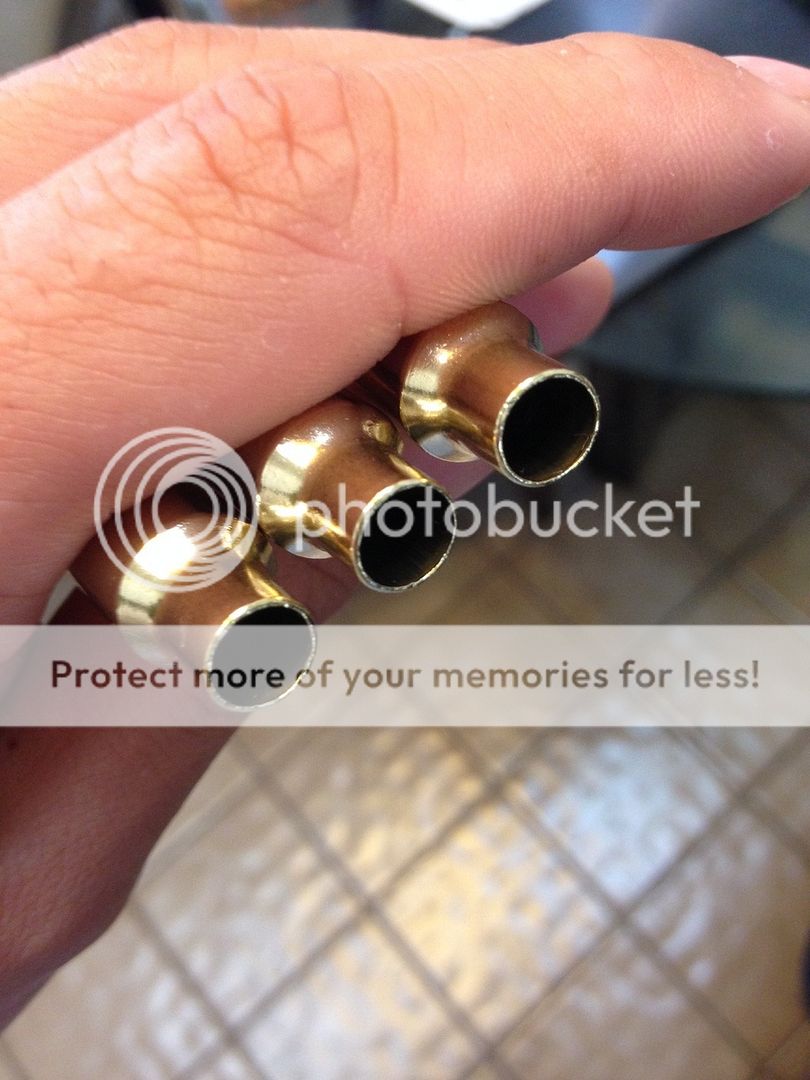

I have a batch of 40 cases going with 10lbs SS media. I'll pull it here in about 40 minutes and post pics! Interested to see the results myself.

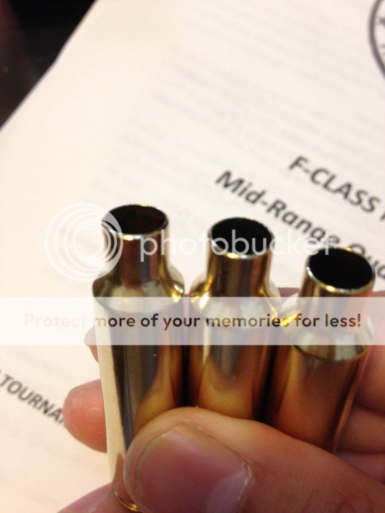

Lot better with less time. Still notice that the case mouth has some peening.
1-hour, 10lbs
Pockets are 80-90% clean
May try a 13 lbs Media and a half hour next time.
I cant help but notice you have a heavy chamfer on your case mouths- i call it a cookie cutter. I think if you chamfered less you wouldnt have the peening issue. I can tumble mine for 2hrs in 5lbs of pins with 100cases and dont see that. One very quick touch with the chamfer tool and they look exactly like they did before i tumble em. I have done 50,100,200 ppc cases with the extremely fragile .262 necks and never seen that

Sorry but impossible to see with those photos. Just want to do a sanity check on the term “peening”. “Peening” is the peeling back of the end of the neck so that if you slide your nail from the shoulders to the case mouth, the nail will catch on the lip that is peen back. “Peening” is not the small impact pattern on the end of the case mouth. Not saying that is what you are saying but just want to make sure we are all on the same page.
No. I must be using the term wrong. I don't experience that condition.
What I'm describing is the brass rolling inside towards the case mouth.
If you take a sharp instrument like a dentist pick and drag it across the inside of the case mouth it will likely catch a small amount. This goes away after chamfering.
Thanks for the feedback Dusty.
I didn't neck turn until recently and most my dies were factory.
Due to the high neck tension if I didn't use an aggressive deburr/chamfer during seating the case mouth would scuff my bullet jackets.
My aggressive chamfer is a throwback to those days. I'll be backing it off since my handloading techniques have evolved.
