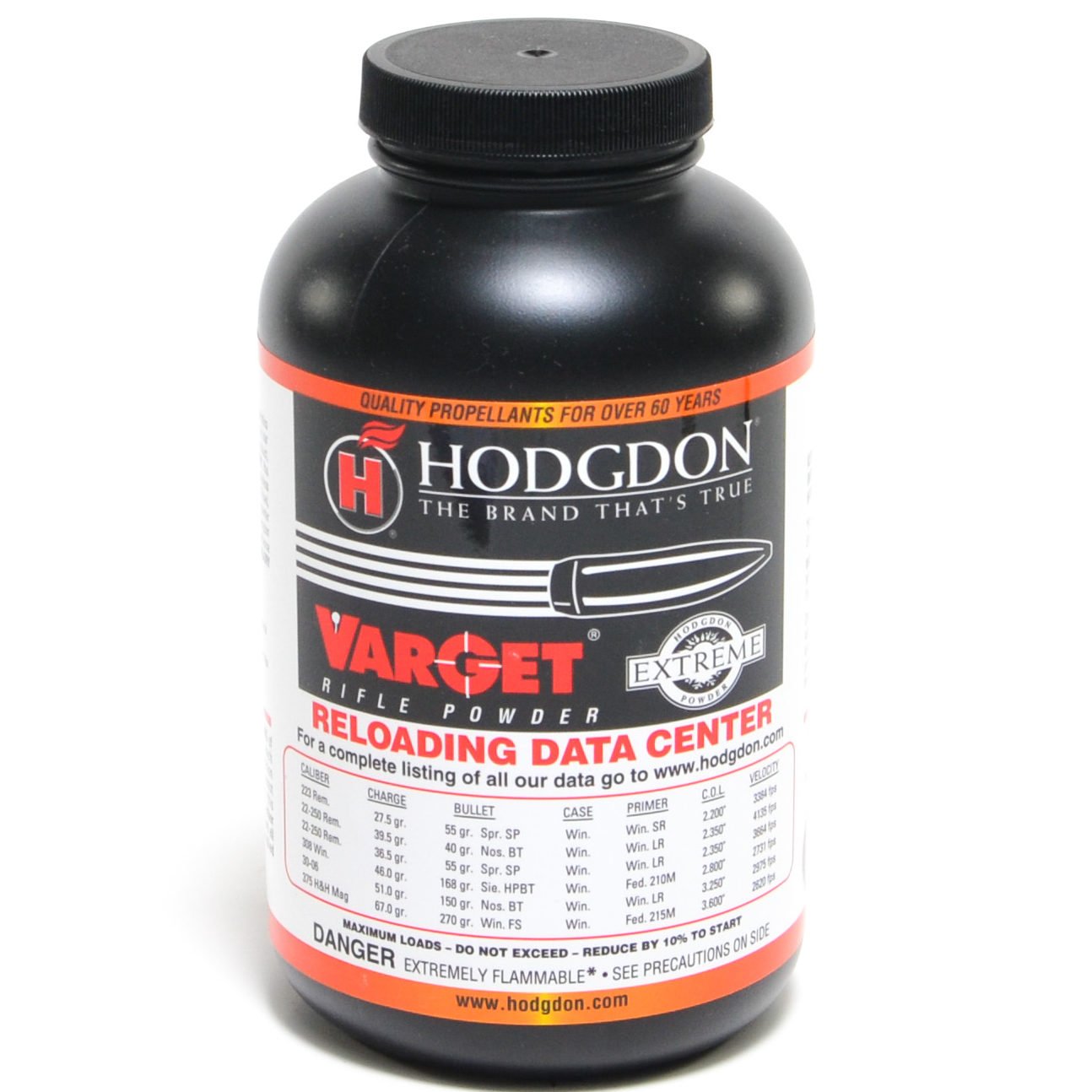

I have some StaBall match but I haven’t used it yet, I’m curious. That being said Varget has been pretty easy to get lately. Powder Valley has one pounders at a decent price, 8 pounds would run you less than 350.00 plus the usual shipping and Hazmat. The Hodgdon website also has it buts it’s more $$
About same burn rate as Varget. "Maybe" a splinter slower,.. so on average it takes 1 gr or 1.5 gr to reach same velocity. Max loads with Staball Match are in the area of 1 to 2 gr more depending on the bullet ( heavier bullets probably closer to 2 gr to reach max and lighter than 155 gr bullet like 1 gr extra to reach max.

I've shot some in a 308win with 168 smk and accuracy was comparable to Varget.
For this 308w rifle the accuracy node with Varget is 43.4 - 43.5 gr. With Staball Match was around 45 gr. ... I've only done 1 round of testing thus far with the Staball Match.

VV-N140 seems to be really close to Varget burn rate.
Incidentally, for those considering Viht N140 as a VarGet replacement (an excellent move in many combinations), just be a tad wary of some of Viht's newer maximum charge weights. Over here, Viht has a reputation for really anaemic max charges which goes back to their early days 30 years plus ago in some cartridges, especially 308 Win. Not any more! Some of their recent maximum loads are over the top IMO and might produce problems in some barrels and chambers.

I had a load of 155 Scenar in 308win with Varget. Shot phenomenal at 2,995 fps from a 24" barrel, and no pressure signs... That's until the 4th firing. Original load was 47.2 gr Varget ( Hodgdon lists 48 gr MAX with 155 SMK ). After getting pressure signs on the 4th firing I backed down the load to the next node at 45.2 gr Varget.,,. yet still the pressure signs remained. The Lapua brass was trashed after the 5th firing.

" Hodgdon lists 48 gr MAX with 155 SMK" - 47g, compressed, according to their website - my "pet load" (paraphrasing Ken Waters) is 46.5g in a Lapua Palma case.

They say it's burn rate is Varget burn rate. Can anyone verify that ? Thinking of trying it in my Dasher and my 22-250 AI. Since my Varget is running low.
