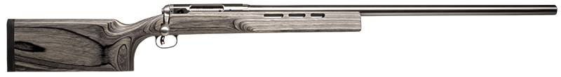

I do wish Fred would do a Savage F-class stock style. Maybe add
about 3 more inches to the length and rail track it.

Add to that, make those washboard cuts on the bottom of the forearm and stock, optional. They make smooth bag riding more difficult. just a personal gripe...
Hoot
