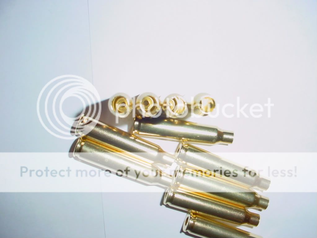

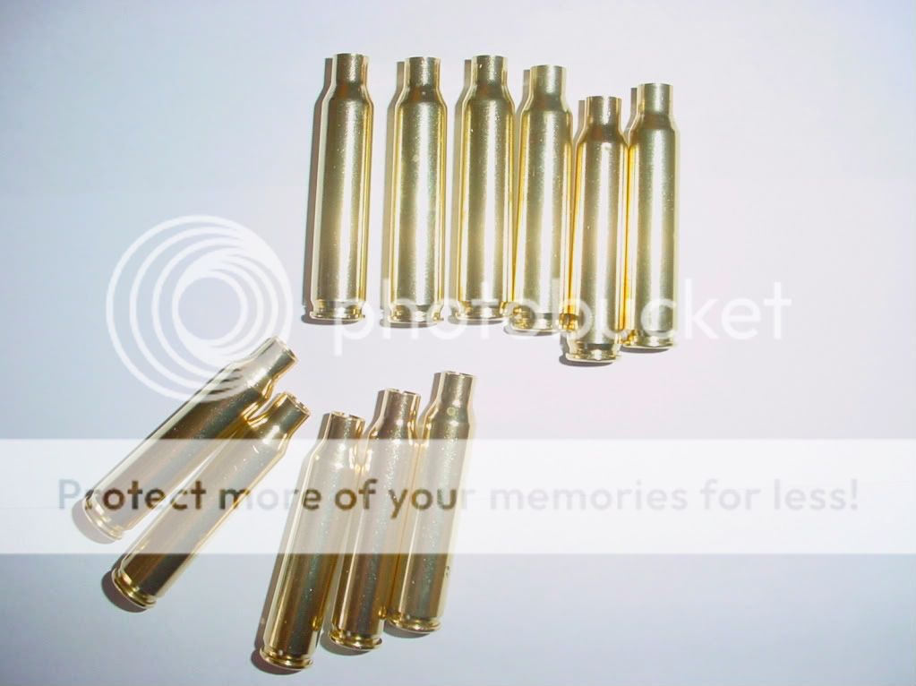

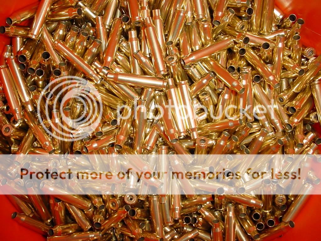

The bottom photograph is 2,500 rounds of .223 / 5.56 MM that were cleaned in Stainless Steel Media, then polished with crushed corn cob and Dillon Rapid Polish. The top 2 photographs is some range pickup brass that just received a wet tumble in Stainless Steel Media with no polish. You can see the degree of cleanliness that is achieved. All with no "peening" anywhere on the cases.
This range pickup brass was BLACK and caked with mud when I picked it up off the ground. You can see the results. It even polished the burr on the inside of the flash hole. So I can't see how proper wet tumbling would cause this "peening" condition?
The brass shown with case mouth peening was most likely over agitated. This can occur if brass is tumbled in a cement mixer, or other type of machine with metal paddles. The Thumblers Tumbler, and others like it are completely rubber lined with no exposed metal the brass can bang into causing the dings shown. Like anything Stainless Steel Media has to be used correctly in order to achieve proper results.
