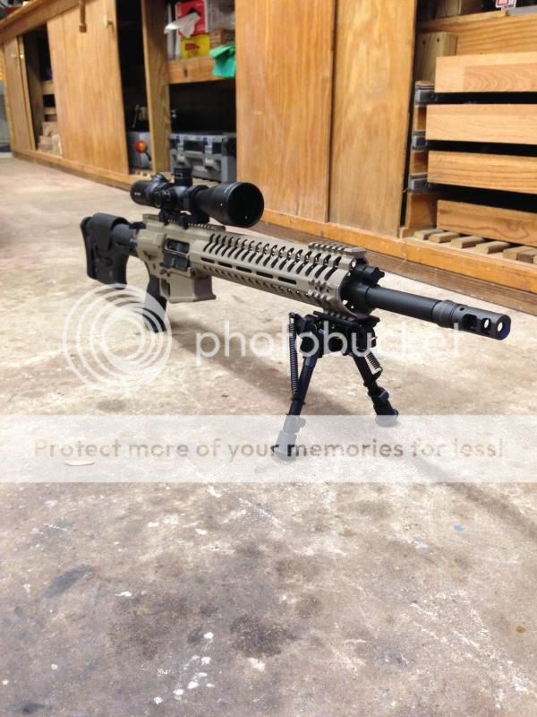

I use a gas gun for Mid-Range F-TR and it does well for me. Krieger fitted one of their excellent barrels to one of my uppers and I assembled the lower with a Geiselle trigger and a Magpul PRS stock and some other accoutrements.
To complement properly this wonderful rifle, I developed and then assembled in large quantities, a handload that I believe does it justice. Of course, the bullet I use could not be seated to mag length, but that's not an issue because F-class is all single load. I also did not relish having my carefully assembled loads with expensive long bullets violently cycle through the AR-15 mechanism. I place my cartridge on a Bobsled and I push it into the chamber before releasing the bolt.
I also used one of those fancy Sinclair Gen 2 bipods and never a Harris.
I discovered over time, that Lapua or Winchester brass made no discernible difference in the gas gun. The brass gets beat up some, but since I have a chrome silicon buffer spring and a carrier weight system device in the bolt carrier, the post-ignition brass massaging was diminished greatly. My brass only flies about 2-3 feet from prone.
After starting with Lapua in the AR, my next batch was Winchester and I saw no difference on the target; the scores were the same and increased some over time as you would expect. I do more prep work with Winchester than with Lapua, but since it gets mangled by the AR, that difference soon gets lost.
I F/L resize the brass with a small base Redding S type, tumble clean, prime I load and go.
