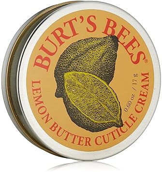

This stuff works like imp was and is good for your handsView attachment 1034024
My new favorite is Burt's bees cuticle cream...My fingers are dry and cracked so I was putting some on before resizing some brass so I gave it a whirl .I tested it side by side with Imperial wax,I felt no difference. Win/win in my book.
