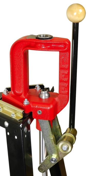

Oh, because of the sale price I purchased Lee’s cast iron press. I have 7 mounted presses and didn’t need it, but it is a monster. Even though presses have nothing to do with the finished product, I can’t help myself. That Lee is very impressive.

Do you have a picture of that Lee cast iron one .
I haven't seen one of those and very interested.
I need a big monster press.

You want a monster press?
This is it. I have an RCBS A-4 which undoubtedly was the champion. A Hollywood Senior crazy strong. Neither is any longer available at a reasonable price and the Hollywood’s you have to be concerned with whether it’s real or not.
This Lee press is reasonable price wise. The design is superior in some ways. ( handle attachment the best way it can be done)
Of course I’m not testing anything for strength but that Lee Cast Iron is running up in first place if you want massive construction.

Remember the press has zero to do with accuracy, but usability combined with the strength to F/L size anything including 50 BMG.
The so called ‘ breech lock’ ( interrupted threads) works perfectly.
