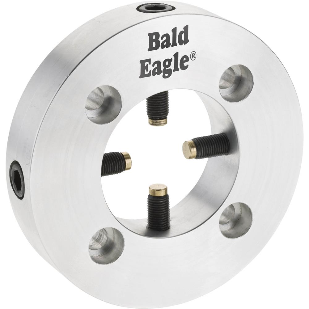

A couple days ago I started dialing in a barrel at home with my old 4-Jaw. I got so frustrated with it that I pulled the barrel and pulled the chuck. I cleaned off and assembled the thick D1-4 backplate I had bought a couple months ago, and grabbed the Bald Eagle spider I had bought years ago. I machined the backplate with a .030" recess to get the aluminum spider aligned and true.
All I need to do now is drill, tap and install it.
I was EXTREMELY surprised that I would come to prefer the spider over the 4-Jaw by such a huge margin. I guess it's what you get used to. The inboard spider is soooooo much faster for me now....

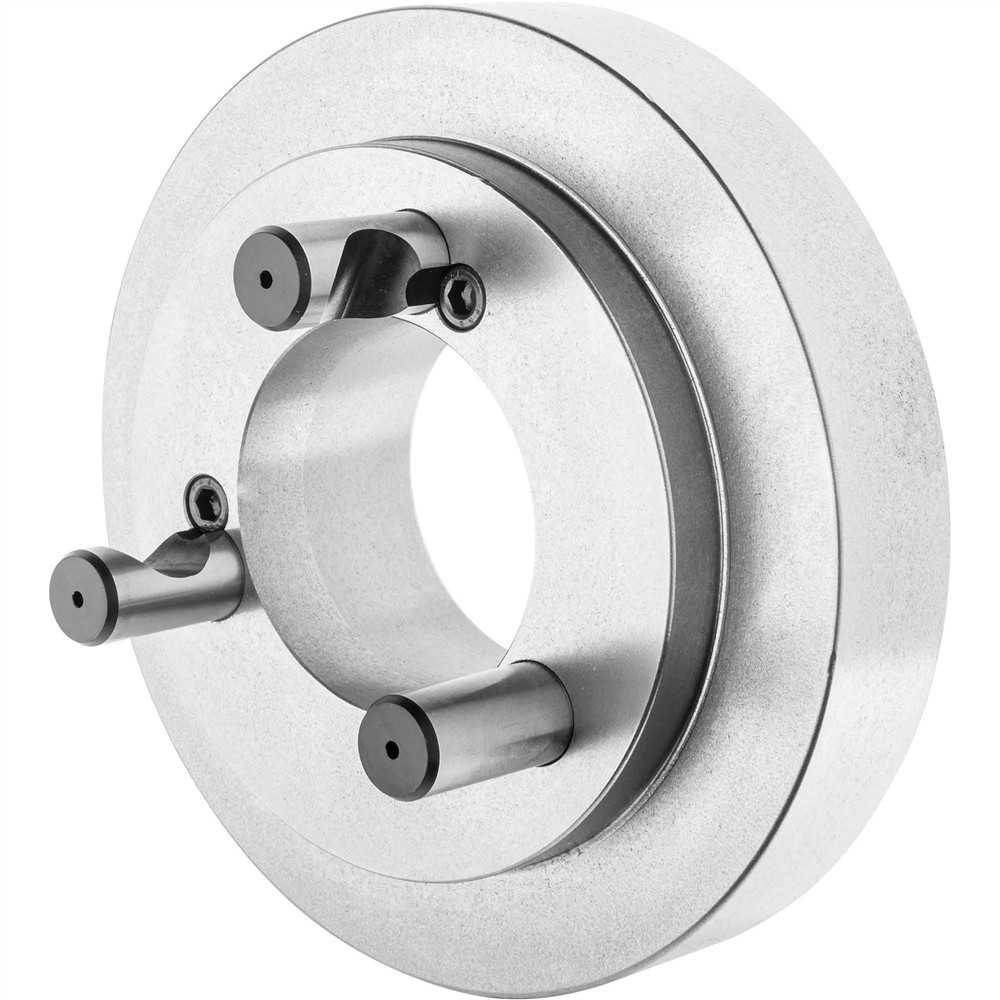

The issue with the Grizzly aluminum spider plate on a D1-4 is one of the spider plate screws will interfere with one of the cam locks on the backing plate. That's why I bought the 1" think back plate. I am hoping that by using a shorter bolt on the hole I'll avoid any issues. I have some measuring to do before I drill my holes.
I went with 3/8-16 Allen head bolts. I think I will red loctite them when I do final assembly.
Just some fruit for thought, I also went with the extra thick back plate as you but then just drilled and tapped it. Saves another inch for overall length to reach both spiders.
You mean you drilled the edges all the way through and tapped that for the spider bolts themselves? Any issues with the cam locks?
